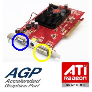

All the talk around here in other threads got me thinking about when I installed my GPU about 6 years ago (or so), so I would call up some pictures of the units as I was away from the machine. This is what I found:
The GPU was purchased first.. it was a Visiontek Radeon HD 2400 AGP Pro 512k.. kind of looks like this:
Pretty good card for a (then) 4 year old computer. Apparently the manufacturer specified the card had to be AGP, etc etc.. so it was one of the only options.

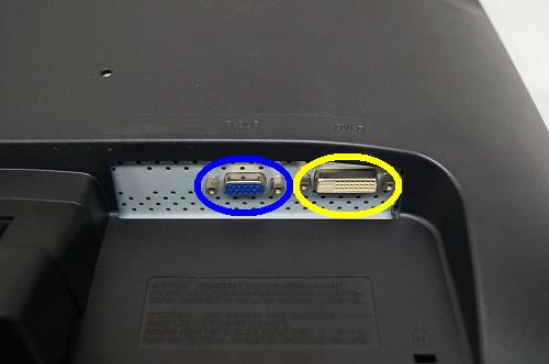

Fast forward 3 years ago, when I needed a monitor. Found the LG Flatron E2041 at BBuy for about $100 and just loved its size and clarity. So I brought it home and replaced the 17" CRT that came with the computer. Plugged right in and away I went. Had some problems with the drivers though that were never really figured out but what the heck, it works. The connections look like this:

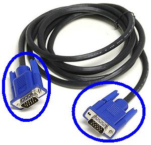

And the only cord I had at the time was this:
I'll let you figure out what happened next.
So.. for the last 3 years I have been running this beautiful HD LG Flatron E2041 on the VGA port from the GPU.
My question is now.. do I bother getting a DVI cable? or just keep kicking myself in the bottom for the unbelievably stupid things I am capable of doing?

After crawling around in places that I haven't seen in years, I see that the GPU is DVI-I and the Monitor is DVI-D.
Cables come as such or will I need an adapter?
Thanks for the help.
  Quote bprat22 Quote  Post ReplyReply bullet Posted: 07 Mar 2014 at 2:20pm
Your dvi-d monitor cable will fit into a dvi-d and a dvi-i port. A lot of video cards have both.    Assuming all dual link.

I have installed said DVI-D cable.  I used to like this little cheap monitor.. now I love it.  There is a noticeable difference between the two cables, even with my old worn out machine.
