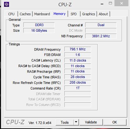

  Quote police215 Quote  Post ReplyReply bullet Posted: 01 Apr 2015 at 8:54am
Here is my CPU-Z memory
Edited by police215 - 01 Apr 2015 at 8:57am
  Quote bprat22 Quote  Post ReplyReply bullet Posted: 01 Apr 2015 at 10:17am
It shows your ram timing at 11-11-11-28 .  The DRAM frequency you double, always, and you have your 1600 mhz.    The DDR is double data rate and CPUZ shows you the single data rate.  So half.

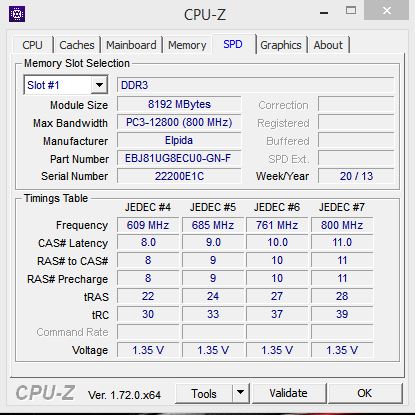

The JEDEC in the second pic, I believe,  is just the different ram specs  that have been tested and certified for that ram   by that engineering council.   That doesn't mean other rams won't work, however.   Just what you can expect with that ram.
The 9-9-9-24 you posted  is a better latency.    Big%20Smile
