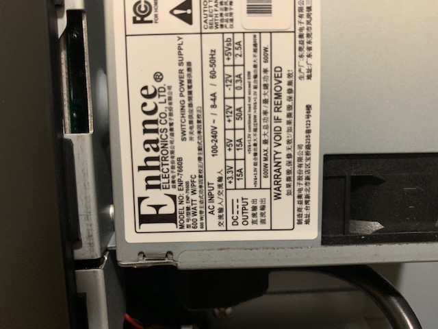

So I watched the video and got the back off. Couple things I noticed about mine is that it is organized a bit diffently than the video. Not a whole lot of difference but some. I see two M.2 slots both empty and a m.2 Wifi spot empty also. I have a USB Wifi. I do not see a hard drive visible. But I do know I have one lol. Plus one thing I noticed is the Power supply is 600Watts which to me is not bad. Not as high end as other computers but not bad.
