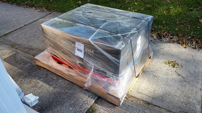

I ordered a Hailstorm II recently with a stage 3 Hydrolux system and It arrived in great shape.  I only had to reconnect 1 case fan.  It was shipped freight also but for some reason It arrived without the pallet as in the above picture, so I was a bit worried  when I opened the box up.  But like I said it arrived in great shape.  I forgot to add that it was shipped to Columbus, GA so I wouldn't worry too much.
