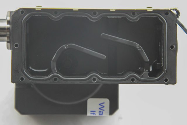

As you can see the bolt with the yellow fluid, the fluid indicator has those thin black curved lines...what exactly are those? Thanks

  Quote bprat22 Quote  Post ReplyReply bullet Posted: 11 Jun 2016 at 9:36am
I want to say they are baffles because the reservoir, technically, can be mounted 2 ways and this helps with the flow, but I could be way over thinking it.  Big%20Smile

Found this picture.   Those lines are baffles to direct the returning fluid to the pump/ outlet.
http://www.digitalstorm.com/forums/uploads/6454/swiftech_h220_reservoir.jpg

  Quote Meller Quote  Post ReplyReply bullet Posted: 11 Jun 2016 at 11:08am
They cause a divide too. Without them, depending on where the in and out ports are, you will end up causing your coolant that just entered the res to immediately leave. This can cause several issues from within your res. A tornado/cyclone effect can end up causing air bubbles to form also. Which, we don't want air in our loops, obviously.

  Quote bprat22 Quote  Post ReplyReply bullet Posted: 11 Jun 2016 at 11:24am
Not so sure about Meller, but I am awesome.   LOLLOL
Meller and I are twins, born a day apart the end of July.
That pic... the fluid comes in from the left , rises up a bit and carries to the bottom within the baffle.  Like Meller said, prevents turbulence, cavitating, etc at the pump pickup.  Don't want any air getting in there, is one scenario.
