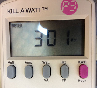

We noticed a lot of customers had questions and concerns about how much power the Bolt uses since it comes with a 500W unit. The 500W unit that powers the Bolt is a high-quality Gold rated efficient power supply with a single rail design. It was custom built for the Bolt system as it was normally a 1U server rack mount based unit. The Bolt chassis also has a dedicated side vent to help ensure the power supply stays nice and cool under even the most intensive tasks.
Let's dive into testing. To really challenge the power of the Bolt, the team decided to run the stress-tests using the most extreme configuration possible, which is the Bolt Level 4 with NVIDIA's fastest single GPU card, the GTX TITAN 6GB. This configuration is fully decked out with an overclocked CPU, SSD, mechanical hard drive, 16GB of memory, optical drive, etc...
To measure power draw, we used a "Kill A Watt" unit that was directly connected to the Bolt's power supply cord and AC power outlet.
(1) The first test was running the Bolt system under a gaming stress-test, we ran Unigine's Heaven benchmark at a resolution of 1920x1080 with all visual settings maxed. Results on the Kill A Watt meter were at a highest rating at 301 watts of power draw.

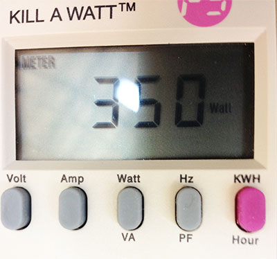

(2) The second test included running a CPU stress-test and a gaming stress-test at the same time. A torture test that practically no level of PC gaming would ever reach. We ran LinX which stressed both the CPU and memory at the same time and ran the Heaven benchmark at the same time with all visual settings maxed. Results on the Kill A Watt meter were at a highest rating at 350 watts of power draw.
