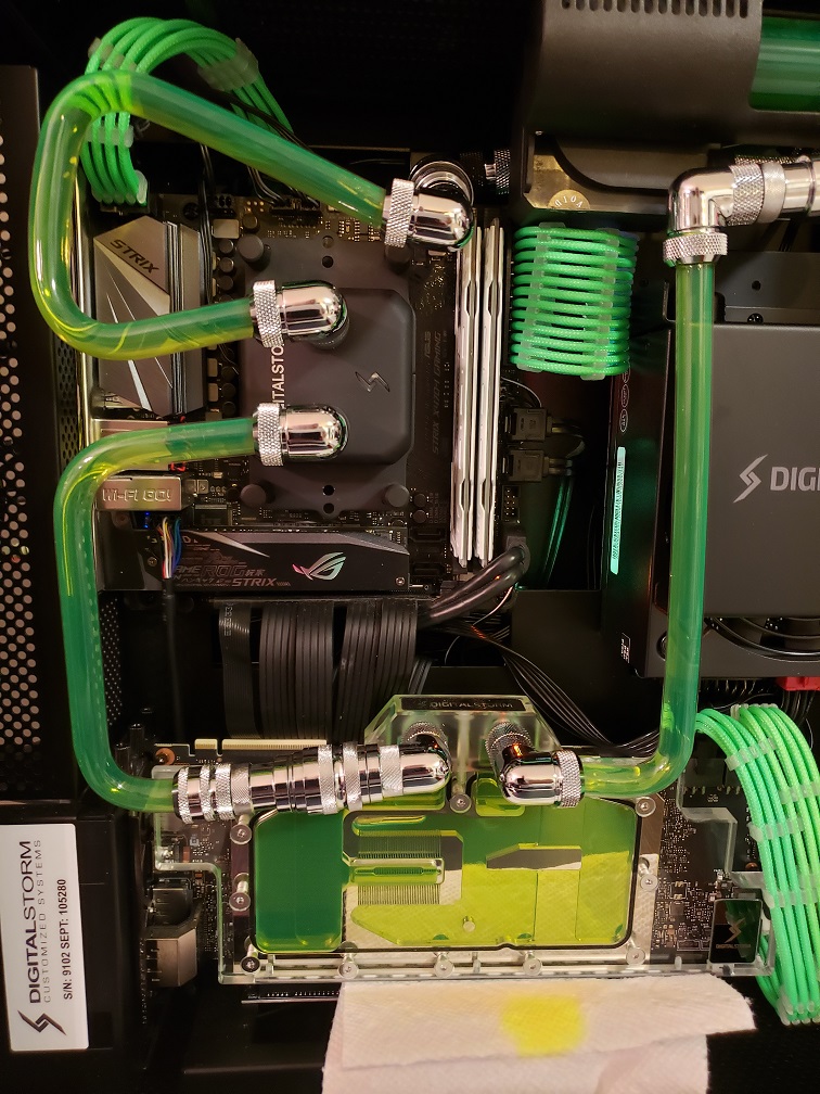

Hey Folks,
I took delivery of my Bolt X 8 days ago. On the 26th I noticed a electric and plastic burn smell. I turned on my case lights and discovered that my water-cooling pipers were melting and bending. I panicked and turned off the machine and almost burned my hand on the case. I contacted digital storm that evening and have not heard back and if I don't hear anything by Monday I will call them.
What would have caused this!? The system was brand new and stock all around. We even discussed a thermal issue before the system shipped and they believed it was a Overclocking issue so I had them remove it...Is the pump bad? Radiator bad?
IMAGES BELOW:
DELIVERY DAY:
MELTDOWN:
  Quote hoserator Quote  Post ReplyReply bullet Posted: 28 Sep 2019 at 4:55am
Wow, it sure looks like the pump failed and the uncooled cpu bent the piping.
Send Alex an e-mail also. [email protected]
Unfortunately if parts are going to fail, they usually do it early. Small consolation. You are still within the free shipping window for warranty work so I'd use it.
Good luck and keep us posted.

Edit: RMA process took 2 days. It just shipped back to me. Alex stated the team rebuilt the entire water-cooling system to ensure there was no leaks and replaced the pump because it failed. Once again they went above and beyond.

Just took re-delivery an hour ago. Once again another defective part. This time upon first launch its the graphics card. Pink lines all over my screen. I tried different cables, outputs, screens and monitors. I'm starting to lose faith that the card will work.

Second RMA process has finished. Returned back home to me for a second time today. Found once again despite a new 2080ti and watercooling block on the GPU, there is a Code 43 error from the 2080ti and it was artifacting with green and pink lines again.
While on the phone with support discussing the issue and working the problem I discovered there was a water-coolant leak coming from a pipe close to the pump and splashing near the GPU.
I am waiting to hear back from a technician / manager. Sadly this might be another RMA from the looks of it. Digital Storm and their team has been really helpful I just would love to get this machine to a point where there are no issues.

So far this is the tally on this computer. Mind you I have never really got to use the computer at all. I'm really worried.
Tally:
- Delivery Week was September 26th, 2019
- 1st RMA : 1 Dead pump (October 11th)
- 2nd RMA : 1 Artifacting / Code 43 error 2080ti (October 30th)
- Possible 3rd RMA: Artifacting Code 43 error 2080ti ...Coolant Leaking above GPU and Loose screws falling and rattling inside the case. (November 14th)
RMA Results:
1st RMA: New Pump in system + Redid the watercooling loop / system in machine
2nd RMA: Replaced 2080ti? Replaced some piping and watercooling block.
3rd RMA: Not started yet.
Appearance of Machine after RMAs:
Delivery
1st RMA:
2nd RMA:
Edited by FknLeon - 14 Nov 2019 at 10:53pm

The Bolt system is seriously starting to worry me. It's been under constant repair since with 3 RMAs.

Think you NEED to go soft tubing to survive shipping to your location, and a GPU bracket to eliminate card movement.   Hard tubing magnifies every shipping bounce because it has no give...no flexibility. Worse filled with coolant.
You could always change to a sturdier Lumos or Velox build, but I suspect the tubing change would do the job.   You could also try having DS ship it drained, and fill it at your end after inspecting that all the connections are tight on arrival.

Just got an email tonight and after two weeks the RMA process has finished. Longest one so far, very surprised but they did send me a personal email to let me know everything that was repaired.
They had to redo my loop again and put a new 2080Ti in.

The good thing I can report is that the system is working, no leaks and the 2080 Ti Functions. Time for the bad news...this is how I received the system...
