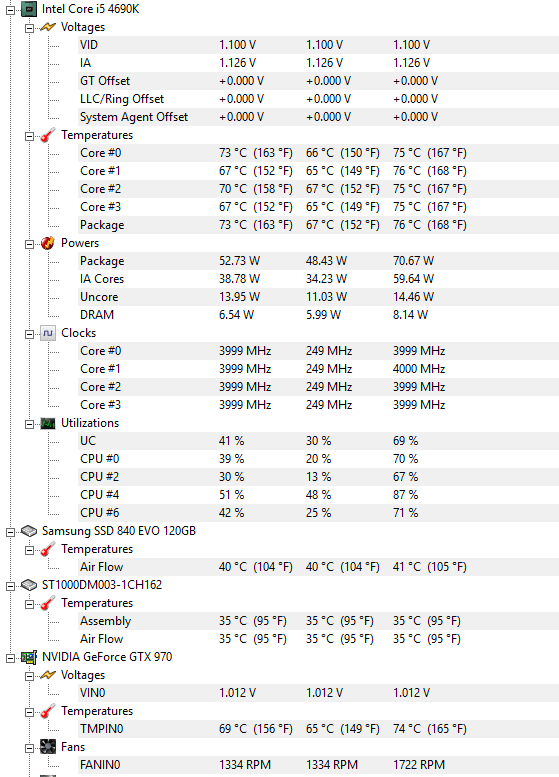

This might be a stupid question, but I can't find a solid answer and was wondering what people thought about the current temps my computer is running at. Any insight would be good to help calm my nerves lol.
This was taken while running one game and a few programs FYI.

well, you don't have any core outside a 10-degree difference from the others, so i wouldn't think this is an uneven TIM situation.  can you give us a photo of the inside of your rig for an idea on your airflow config (the rest of your components are displaying good temps)?  you can see your cpu loads are in a range from 13%-87% and your temps don't vary much (65C-76C) at those times.  what cpu cooler are you using?  how hot is the ambient room temp?  looks like that is a reference 970 too, so not a situation where the vid card is dumping hot air on the cpu.  i know Haswell runs hotter than my Sandy Bridge, but my temps at load are in the 60's and i'm running a moderate oc on it.  of course i have a D14 cooling it as well.

Looks like good temps to me. Nothing anywhere's near a problem. The Eclipse with its low profile cpu cooler isn't as effective as db's Noctua or my A70 but it still does the job. Reference 970's meaning the single fan type will run at that temp as opposed to cards with multi custom fan setups that keep the card in the 60's usually.
70's C isn't bad at all for cpu and gpu.    Getting into the 80's is when a look see for dust,etc is recommend.
Looking at temps for the first time freaks out some when they see the Fahrenheit temps.   The Centigrade temps are what to look at.
Checking temps every couple of weeks is good practice to see if anything is trending higher which could mean dust building in the coolers/heat sinks. Canned air gently and in short bursts will clean them.

The screen above is from HWMonitor. Most use that. I use it with Speccy, as well, as HWMonitor lists my mobo at over 120C.
