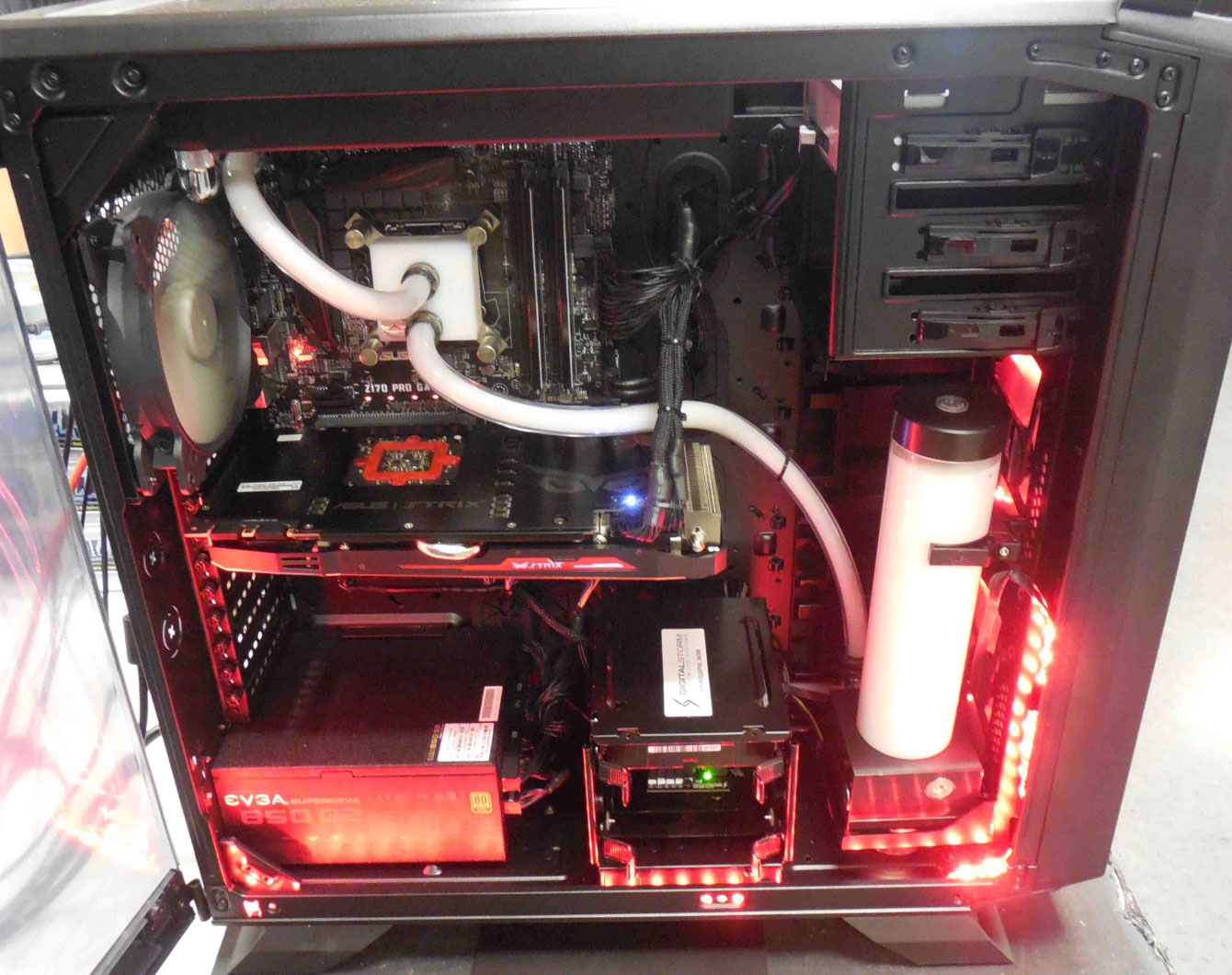

That's not how the computer left the facility. Sorry to hear, we'll do our best to take care of you. Here is a photo for reference of your computer before it shipped, in QA. You can see the fluid is full, etc...

it's probably that fitting right behind the res in the pic Alex provided.
