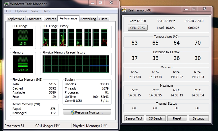

Err....

Are those at idle?
What type of cooling system do you have? If it's air you may need to dust it out.

  Quote ablahblah Quote  Post ReplyReply bullet Posted: 24 Apr 2010 at 4:39pm
that's at idle, though with about 15 programs loading it
I have stock air, dusted it out about a week ago when I had to reposition the cooler (came loose). I'm assuming its gotten loose again....

  Quote Alex Quote  Post ReplyReply bullet Posted: 24 Apr 2010 at 5:52pm
I recommend purchasing a low cost air cooler.

You probably don't want it going over 68c right????
  Quote justin.kerr Quote  Post ReplyReply bullet Posted: 25 Apr 2010 at 12:04am
only thing that counts is load temps, and that is his idle, so it doesn't me squat.
load temps with i7 CPU's, keep under 85C, but with electronics, the rule of thumb is for every 10C cooler, double the life expectancy..

  Quote sirsiddius Quote  Post ReplyReply bullet Posted: 25 Apr 2010 at 6:39am
It stands to reason that if his idle temps are 63-70 then there's a good chance he'll go over 85 once he stresses his cpu.

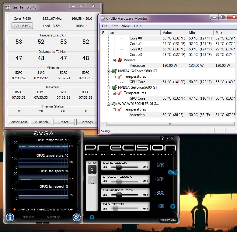

  Quote ablahblah Quote  Post ReplyReply bullet Posted: 25 Apr 2010 at 11:33am
well, let's test that theory...
*runs hyperpi
aight, the max core one ever peaked to was 91C, all other cores were 90C and below at max temp. This was run shortly after startup, with hyperpi going 8M on 7 out of 8 threads.
honestly though, that's obviously most of the cores running at 100%, I never reach that, it's usually well below 50%. whenever I run FAH too, I run on GPU, so my CPU is never really stressed, with the exception of running HyperPi

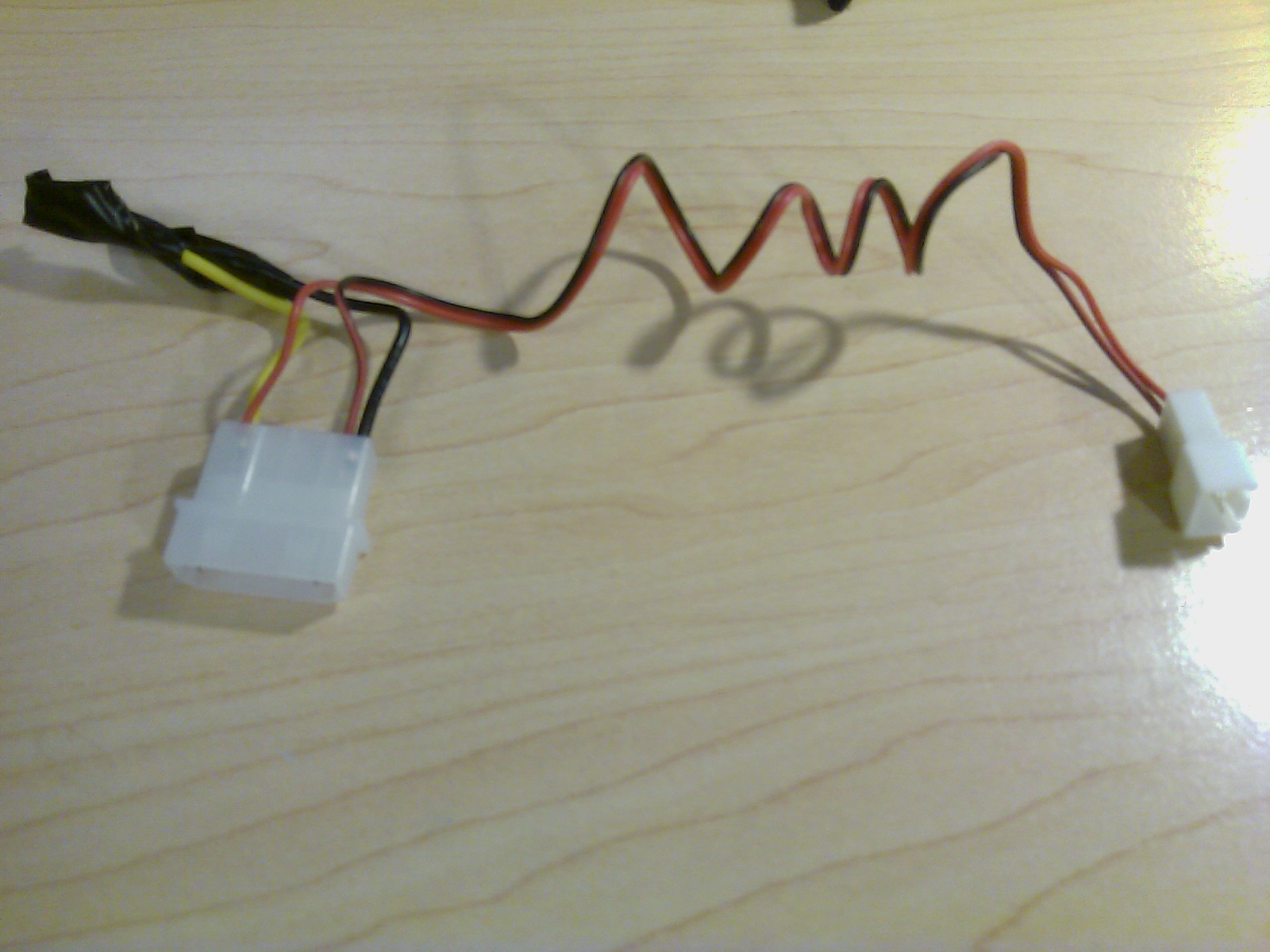

  Quote justin.kerr Quote  Post ReplyReply bullet Posted: 11 May 2010 at 5:29pm
on your 3 pin fan connector, I assume you are connecting it to a 4 pin molex?
the yellow on the molex is 12v, the red is 5v, hook the yellow on the molex to the red on the 3 pin, and the red on the molex to the black on 3 pin. this will give you 7 volts. or hook the molex red to the 3 pin red, and a molex black to the 3 pin black for 5 volts.
lol need pics?   the molex come apart very easy, same with the 3 pin connectors

  Quote ablahblah Quote  Post ReplyReply bullet Posted: 11 May 2010 at 10:40pm
you mean like this?
(I have no soldering iron, solder, crimps, a crimper, nor molex pins, sooo, I just took whatever would be wired wrong off instead of recrimping everything)
Edited by ablahblah - 11 May 2010 at 10:41pm

  Quote justin.kerr Quote  Post ReplyReply bullet Posted: 11 May 2010 at 11:10pm
as long as the two wires off the molex are not touching each other, then yes that is a 7v set up

  Quote ablahblah Quote  Post ReplyReply bullet Posted: 12 May 2010 at 3:26pm
used electrical tape over the pins to isolate them. first put a little bit of tissue paper over it though, since from experience I know that electrical tape tends to leave residue on occasion...
anyways, it runs pretty dang quiet at 7v, still moves a lot of air, ty man!

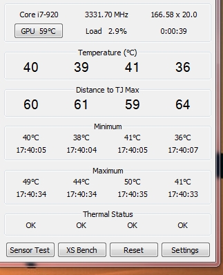

  Quote ablahblah Quote  Post ReplyReply bullet Posted: 14 May 2010 at 5:42pm
ArtiClean ARRIVED!!!
Took me an hour to install, unfortunately, i can't double fan because of my side panel fan, but whatever! MINUS 20 CELSIUS BABEEEE Heart
(Load Temps don't even touch 60 C! YAY)

  Quote justin.kerr Quote  Post ReplyReply bullet Posted: 14 May 2010 at 7:35pm
lol, nice temps.
which cooler did you get?
you could overclock more for sure.

  Quote ablahblah Quote  Post ReplyReply bullet Posted: 15 May 2010 at 6:38pm
mobo f*cked up. big time. CPU somehow running ~55C, GPU's somehow unresponsive to automatic fan control commands, temperature probes going insane. -_- i, hate, XFX now
temps maxing out at 83 C, how the hell is that possible...30C differential...
I'm looking at that screenshot I took before, and comparing it to this...and its not making ANY sense...
