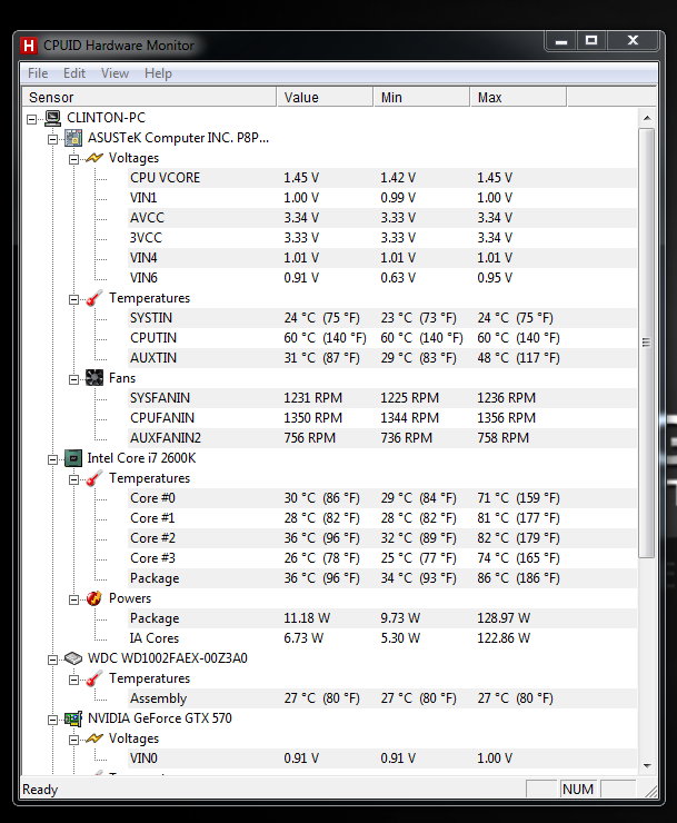

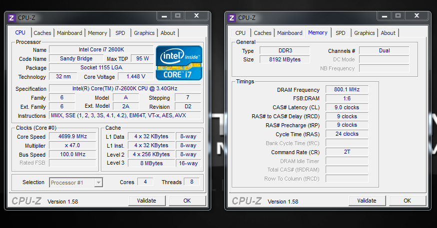

 So I received my computer about a week ago now and have enjoyed it quite a bit. Massive improvement from my old PC by leaps and bound. I am worried about one thing though.
DS was able to overclock my computer to 4.7 GHz but my V-Core is very high even when I first start up the PC at 1.48. From what I have read that is high even under full load and I have got that at idle. I really don't want a dead CPU in a years time. Would this be something I would need to call DS about, or is there anything I can do on my end?

  Quote DST4ME Quote  Post ReplyReply bullet Posted: 29 Aug 2011 at 4:29pm
Call DS and ask them for the highest oc you can get with a vcore lower then 1.4.
at 1.45 vcore and 24/7 use, around 3 years or so your cpu can endup dead, it could be longer it could be shorter, but keep in mind that is if vcore is at that level 24/7.
they will help you change bios settings (oc settings) and then take it from there.

 So I ran LinX and these were my results I got after running it for just 5 minutes. Those temps seem pretty high.
  Quote DST4ME Quote  Post ReplyReply bullet Posted: 30 Aug 2011 at 4:18pm
temps are ok but 5 minutes is not enough, so run it longer, if all cores go above 85c then that is high.

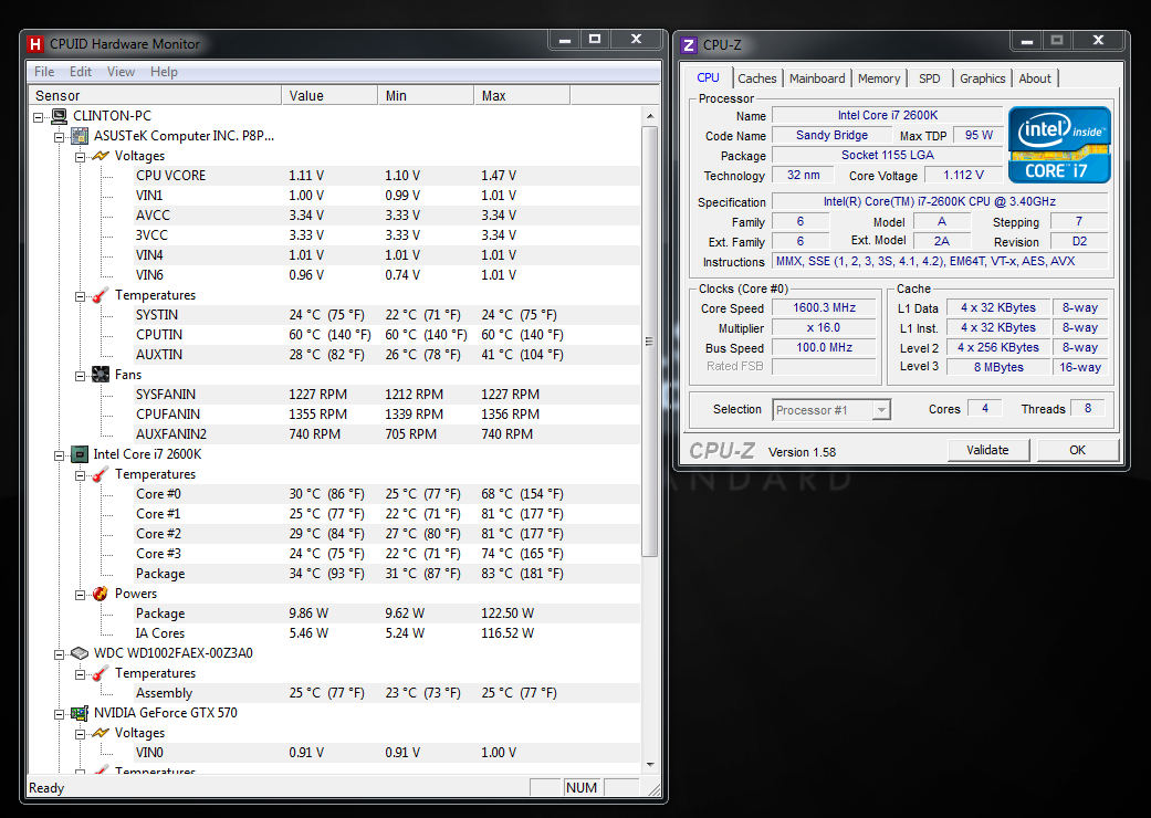

  Quote Cerebros Quote  Post ReplyReply bullet Posted: 31 Aug 2011 at 3:22pm
 Just an update I called DS and was able to set my OC down to 4.5. Was wondering though my vcore at idle is 1.104 and under load jumps up to 1.48. Is that normal to jump up that high?
I ran LinX again and my temps seemed quite a bit higher from the 4.7 overclock. I ran it about 3 minutes before I turned it off since all but one of my cores was reaching 88 and my Package was up to 91.
I would actually welcome some help from you Rice. I have tried to fiddle around with my voltage settings under bios and not much has helped unfortunately.

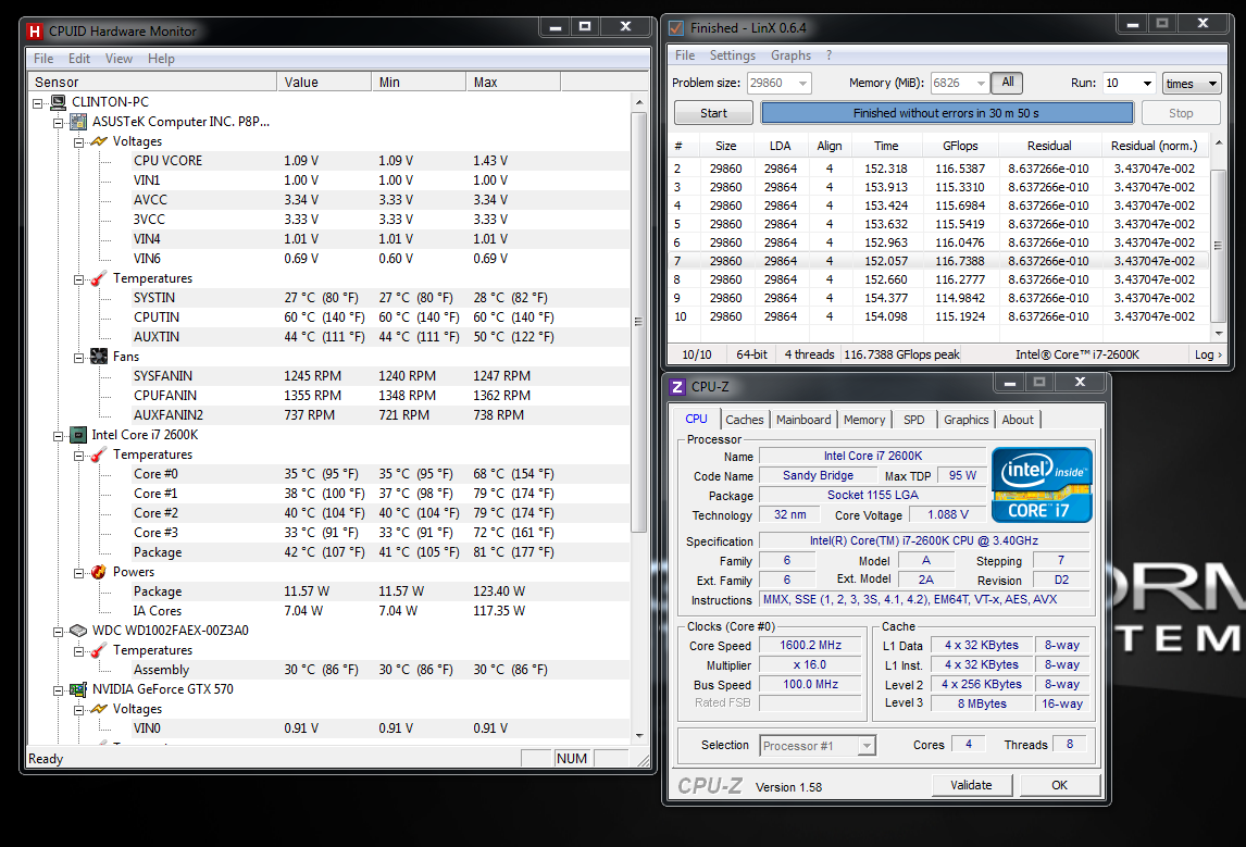

It pretty much just is jumping up and down I have ran 3 passes so far and ranges from 1.372 up to 1.402 being highest so far temps highest is package at 80 and lowest is core 0 at 65
Cerebros View Drop Down
Joined: 09 Aug 2011
Posts: 26
  Quote Cerebros Quote  Post ReplyReply bullet Posted: 02 Sep 2011 at 2:58am
Alright so just finished running 10 passes of Linx. I ranged from 1.372 - 1.431. It only stayed up at 1.4 for about 20 seconds or so then it went back down

  Quote RiceEatin2000GT Quote  Post ReplyReply bullet Posted: 02 Sep 2011 at 3:00am
make sure your not doing anything when doing linx. The voltages seem a bit jittery for when the cpu is under full load.
Try going down another notch on the load line(regular) and see what your load and idle v-core is.

Isn't jumping as much but still is ranges from 1.33 min to 1.40 max according to hwmonitor. On CPUz it still mainly switches from 1.336 - 1.360 mainly but still get spikes
Joined: 02 Oct 2008
Posts: 1699
  Quote RiceEatin2000GT Quote  Post ReplyReply bullet Posted: 02 Sep 2011 at 3:40am
are you seeing 1.4 show on cpu-z when its spiking? It could be hwmonitor reading the v-core wrong. If your not comfortable with the spikes you could overclock by manual voltage which is much easier its just your processor wont down volt at idle(it can still downclock to 1.6ghz)
offset route
i would use cpu-z for the v-core i think you've got a good settings for 4.5ghz stable.
if you wanted to keep it at 4.5ghz i would run a good 20 runs of linx at max problem size and all memory.
if you wanted to push it back to the 47 multi i would do that and change the offset to + .035 and then run 20 runs of linx.
Manual route-
Change the load line calibration to very high
set a manual voltage for a 45 multi to 1.35
set a manual voltage for a 47 multi to 1.375
Run linx for stability.
This may not fix the jittering but its a strong possibility.

It might just be hwmonitor because I reset it about 4 passes ago and it is now saying 1.33 min and the max being 1.37.
I would probably be fine putting this back on manual since when DS sent me this system it was on manual and the tech had me switch it to offset. I guess my only concern is running it at a constant v core, will that kill the CPU quicker?
Those numbers to set it manual when you say 45 and 47 those would be the ghz numbers I would be changing right? Also with all the changes we made for offset will they need to be reverted back to the way they were if I went back to manual?
Thank you again for your help tonight. I am sure you probably have better things to do but I sure appreciate it.
Edit: I think I found the culprit for the high spikes. It was my Norton 360 which starts background tasks when the pc is idle after X amount of minutes. Oops
Edited by Cerebros - 02 Sep 2011 at 3:53am
Thank you again for your help tonight. I am sure you probably have better things to do but I sure appreciate it.Edit: I think I found the culprit for the high spikes. It was my Norton 360 which starts background tasks when the pc is idle after X amount of minutes. Oops
To be honest offset voltage either works for some people or it doesnt and some motherboards dont even support offset voltage for overclocking. Long story short as long as your voltage isn't to high running a constant voltage is perfectly fine.
When im refering to 45 vs 47 its the multiplier its the number you changed when you were on the phone with the tech to bring the speed to 4.5ghz. 45 multiplier is 4.5ghz 47 is 4.7ghz.
"Also with all the changes we made for offset will they need to be reverted back to the way they were if I went back to manual?"
All you would need to do is click on the area that says offset mode and change it to manual and you'll see a field below that to plug in a voltage. If you ever wanted to go back all you'll need to do is change it back to offset + and plug in the offset value to get back the settings. Every thing else stays the only other thing you would need to change is the load line calibration.
