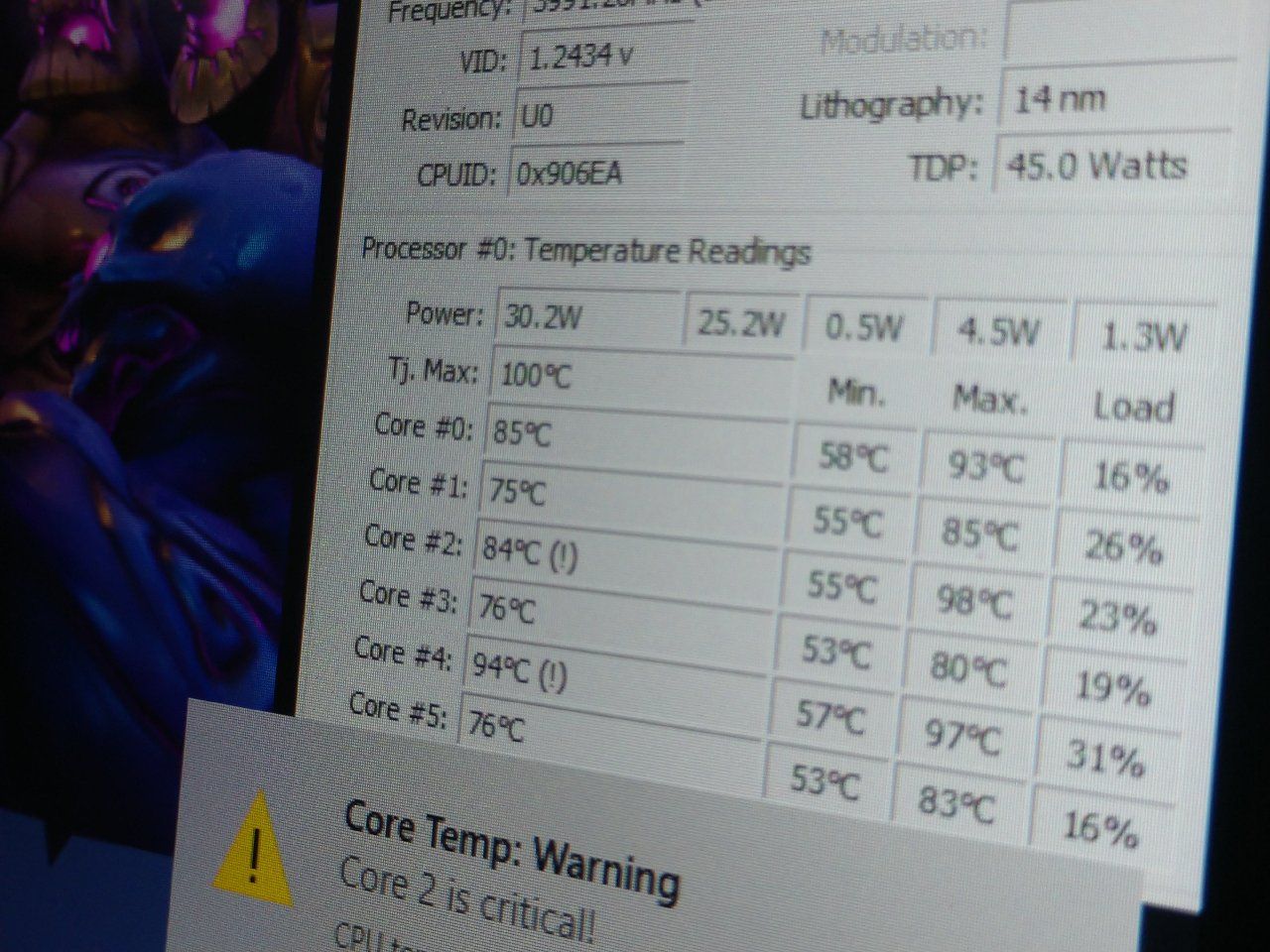

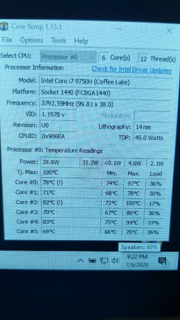

I contacted DS again three days ago. DS said they need the laptop back again to look at it. I am still waiting for a return label. I tried to download screenshots from last night after playing fortnite for 20 minutes the laptop went thermal.

I tried to load images of the temps but it didnt work.
Lets see if these appear.

  Quote GrandesBollas Quote  Post ReplyReply bullet Posted: 09 Jul 2020 at 5:15pm
Excellent information. 3 of your 6 cores are about 20 degrees warmer than the rest. No question that the heat sink is not level.
This is most likely what is happening with your laptop. See the link for the complete forum discussion. Essentially, this problem resulted in motherboard/capacitor failure due to prolonged exposure to excessive heat. The problem you are seeing is a heat spreader (the part that is connected to the heat pipes) is not making even contact with the CPU. This could be do inadequate mounting of the heat spreader; uneven flatness of the heat spreader. Regardless, the laptop cooler (the one that is supposed to work; not the gimicky one you were told to get) is unable to transfer heat. This has been a long running problem with the laptop described in the linked thread.
