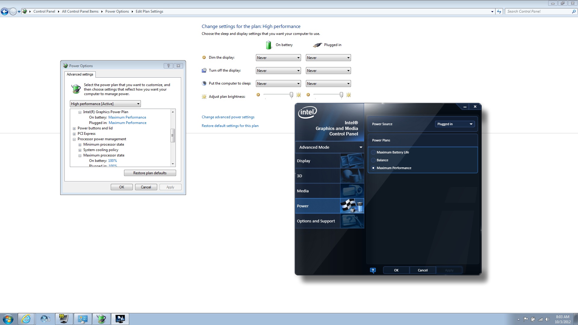

edit: I forgot one thing. When your running on battery only, the laptop goes into power saving mode and you're running on the Intel graphics only so the GPU fan is probably not even spinning up and the CPU is slowing down. Before I bought that line filter, I'd change the power setting to maximum performance while on battery. If the sound comes back while on battery, then you know it's the sound of the fans spinning up.

  Quote Bobby Quote  Post ReplyReply bullet Posted: 03 Oct 2012 at 8:05am
Have to make it big to read.....scroll across.....
Edited by Bobby - 03 Oct 2012 at 8:08am
Bobby View Drop Down
Joined: 16 May 2012
Posts: 322
  Quote Bobby Quote  Post ReplyReply bullet Posted: 03 Oct 2012 at 8:35am
I just noticed....on that last picture of the Intel Graphics control panel....on the top right where the drop down says "Plugged In" change that to battery, then hit apply. I've already done that although I rarely run on battery because, at these power settings, i'd probably get 20 minutes of battery life Big%20Smile
