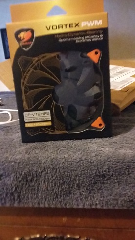

  Quote ArkansasWoman777 Quote  Post ReplyReply bullet Posted: 11 Jul 2015 at 2:35pm
So instead of creating a new post i figured i would revive this post since one of the two front fans were beginning to make noise and were probably going to die eventually. I bought in replace two Cougar 120mm pwm fans. Here is a picture of one.
  Quote bprat22 Quote  Post ReplyReply bullet Posted: 11 Jul 2015 at 2:52pm
Nice fans.
