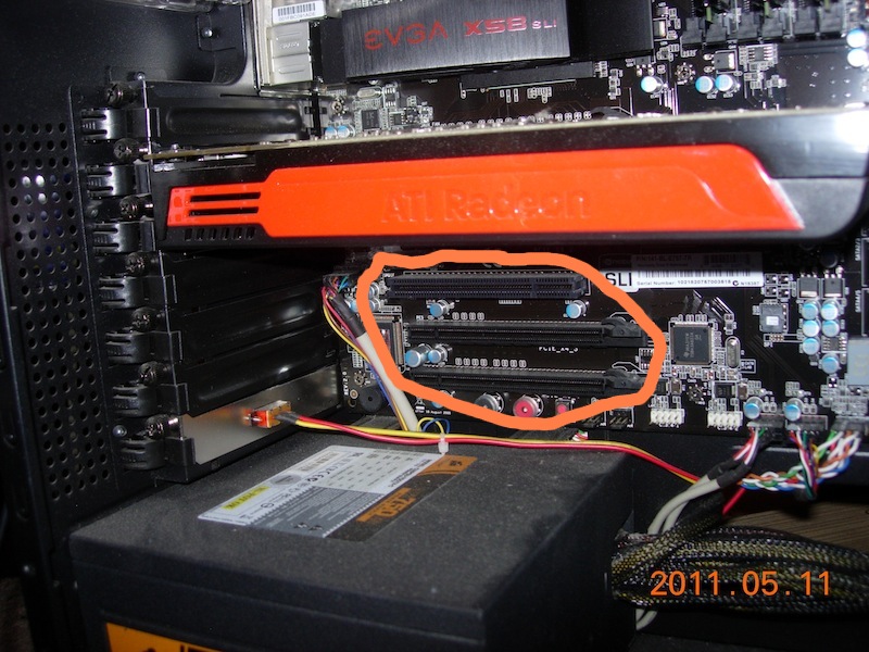

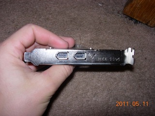

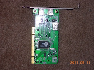

I recently salvaged a dual Firewire PCI card from an old Dell Dimension 4500S, and I was wondering if I could fit it into my Digital Storm computer.
I have an EVGA XLE motherboard, and I noticed several extra slots on the mobo, but I've never installed a PCI slot before, so I'm not sure if it will fit into any of them or not.

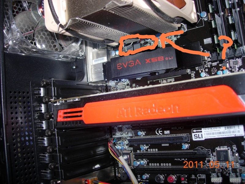

 I also noticed that the motherboard does have a Firewire port available on the back, it just simply isn't installed yet. I think DS didn't install the Firewire that came with the mobo because they wanted to give me more USB slots, but that won't be an issue, because the Firewire connector that was included with my comp also has two USB ports attached to it, so I wouldn't lose much. I'm just not sure how I would do that in the event that the PCI card won't work.
It seems that the connector for this Firewire is located behind the cooling fan, so I don't know if I'd have to remove that first in order to access the Firewire pin on the motherboard and install the connector.

ok well for the pci card instalation is simple just put it in the slot till u hear a click. If you notice there are groves in each pci slot and the card. you have to find a slot that matches the card. if you find one and put it in great. just unscrew the io shield behind the pci slot.
If i have learned anything building my computer its that motherboards are a pain in the ass! lol so many small parts and  big parts blocking them. but if you can get around the heatsink than plug it in if you can. I cut myself on my heatsink 4 times building my computer lol  but taking off the heatsinnk isn't generally a good idea because you would have to reapply thermal paste and its a big pain. don't know why that isn't connected in the first place but the card should do if you have a small slot open for it.

As a PCI card, the card should create its own 1394 link and not require the current 1394 header. PCI is also a form factor standard, so it should slip in with no problems. Just drop it in, boot up, let Windows find drivers, and go.
Also,  isn't the 1394 header set normally supposed to sit next to the USB header set(s)?

1.) It is a Firewire 400 slot, and the two headers I have on the motherboard are for 1394a, which is Firewire 400 as well.
2.) The PCI card will fit into my PCI slot, but unfortunately, I have to disconnect the front audio jacks for it to fit. The card simply
wedges up against the wires and will not fit into the slot, as shown in this pic:
So I face the choice of using the two Firewire ports on the card, and losing my front audio (which isn't a big deal, because I have no less than six audio jacks on the back of the comp) or I get a smaller PCI card that won't interfere with the audio header.
 Since I didn't want to lose the audio, I decided to install the connector that came with my comp, but which DS didn't install. Since that is also 1394a, it fit perfectly into the header, which was located next to the USB headers, as you predicted, Ablahblah. Unfortunately, the rear panel Firewire that I installed also included two USB connectors. I couldn't connect them,because all of my USB headers are occupied.

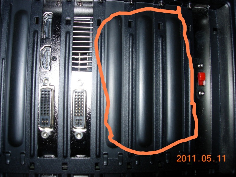

 One final note worth mentioning was that the I/O shield that includes the 8 USB ports on the back panel also included a eSata and 1394 port, but the actual ports aren't installed, as noted earlier in my picture of the shield. Is that because not all  motherboards are designed to match up with certain I/O shields such as mine, or would I have to  somehow attach an eSata and 1394 port myself, such as through soldering it onto the mobo?
