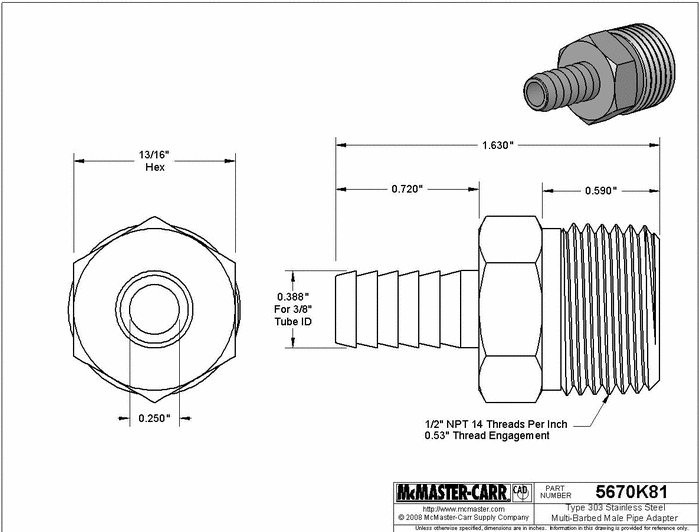

Hey Justin, Sidewinder computers recommended www.mcmaster.com for the MNPT adaptor fittings for the flow meter.  What are your thoughts?  Do you know of a better place?
  Quote justin.kerr Quote  Post ReplyReply bullet Posted: 25 Feb 2011 at 4:00pm
your using 3/8" ID tube??
rholyrag View Drop Down
Joined: 17 Oct 2009
Posts: 841
  Quote rholyrag Quote  Post ReplyReply bullet Posted: 25 Feb 2011 at 4:02pm
Yes
  Quote justin.kerr Quote  Post ReplyReply bullet Posted: 25 Feb 2011 at 4:14pm
yes, then that will work fine, why sch small hose?

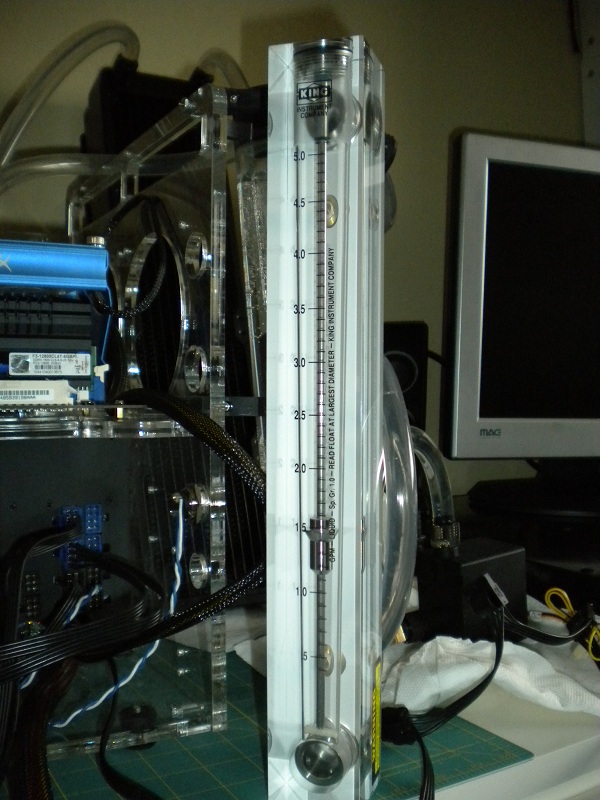

First Test:
CPU Loop
EK 400 Advanced Res > EK DCP 4.0 Pump > Flow Meter > RX480 Rad > EK Supreme HF Block
Just in under 1.5 GPM.
Second Test::
EK 400 Advanced Res > EK DCP 4.0 Pump >  RX480 Rad > Flow Meter > EK Supreme HF Block
Dropped a bit to about 1.4 GPM.
Edited by rholyrag - 06 Mar 2011 at 6:56pm

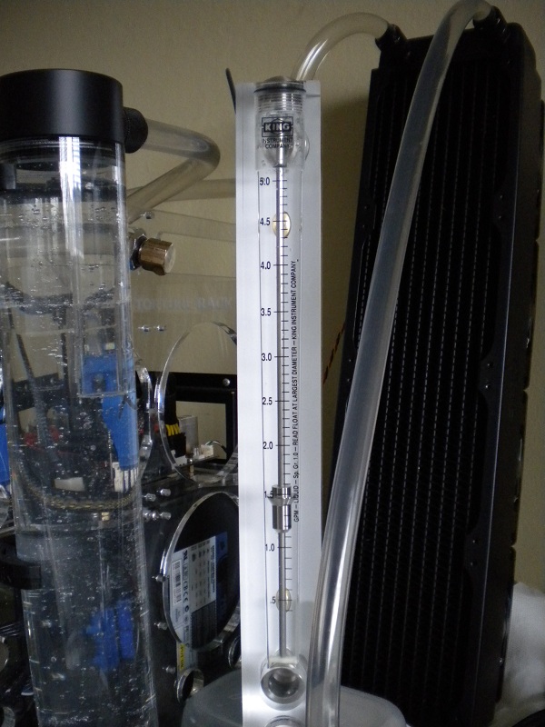

CPU Loop
EK 400 Advanced Res > EK DCP 4.0 Pump > RX480 Rad > RX360 Rad > Flow Meter > EK Supreme HF Block.  Bad picture, but the GPM's with dual radiator and single pump dropped to 1.375GPM.
Dual radiator and dual pump.  Increased flow to 1.8GPM.
EK 400 Advanced Res > EK DCP 4.0 Pump > RX480 Rad > EK DCP 4.0 Pump > RX360 Rad > Flow Meter > EK Supreme HF Block.
Edited by rholyrag - 21 Mar 2011 at 1:10pm
  Quote justin.kerr Quote  Post ReplyReply bullet Posted: 22 Mar 2011 at 9:49am
1.8GPM very nice. Pumps are nice and quiet, have redundancy if one fails,  what a great combo.
Adding more radiators usually has very little effect on flow, unless they are the Black Ice stuff.
Flow may improve slightly when all the air is out. lol Big%20Smile
which plate are you using on the water block?
Edited by justin.kerr - 22 Mar 2011 at 9:50am
