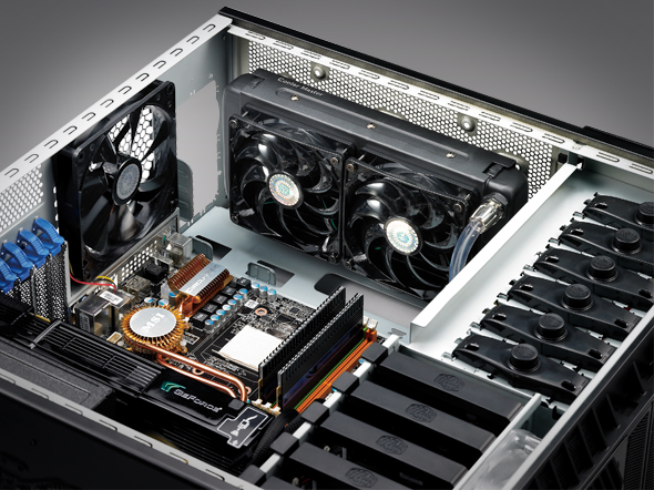

I received my new PC 2 days ago and I am absolutely lovin' it!  Before I get too far into this post, let me begin by saying that I'll have my review and pics posted sometime in the next day or two.  Anyway... on to my questions...
I have two questions about my case (HAF 932 case).  The first is easy in that it concerns the top two LED indicator lights (Power and HDD activity).  The HDD activity light on my PCs in the past are normally blinking with activity, but this one doesn't.  It is no big deal (think very minor and almost not worth mentioning), but they are very bright to begin with and I didn't know if this was normal (basically acting like 2 power lights).
The 2nd one is more in depth a tad:  The HAF 932 case (using the Stage 2 Air cooling method) was upgraded with the airflow upgrade chassis with antec blue LED performance fans (up to 6 fans) along with the default blue lighting.  This option only seemed to upgrade just the one side fan with 4 smaller fans, but none of the others.  I was totally expecting the front red fan to be blue with this upgrade, but it wasn't so that is a little disppointing.  Anyway... when I was using the configurator to design my system it showed (and currently shows) the following image for the HAF 932 case:
As you can see from the image above, it shows air coming from the front and also air coming in from the top.  The front fan on my system is blowing in as designed, but the top is blowing "out" (and not "in" as the image shows above).  I can't help but wonder which is correct?  I can think of 3 options here:  either 1) I am misreading the image above (which is always possible), 2) the image above is incorrect and the top fan should indicate air blowing out or 3) the top fan on my system was built wrong and it should have been blowing in.  If it is in fact blowing the wrong way, would you recommend that I switch it (I haven't even looked yet to see how easy/hard it would be) or leave it alone?  Since I am using only air to cool the system (the Stage 2 Air upgrade is great by the way), I want to make sure I am able to give the system the air it needs.

First it looks like the fans on the top should be blowing in so I would say that yours are backwards.  As far as the front fan being red, I would have thought they would have changed that for you to blue since you got the upgraded lighting package. I did not get the fan upgrade but I did buy the blue light for the front so that all lights are blue, I got it from Cool Master, I just think they made a mistake on yours. I would call them Monday and ask about it.

Also take a look at this picture, it shows the fans blowing in on the top, look at the direction of the blades.

Onkel_Ken, which way does the top fan blow on your HAF 932?
  Quote Onkel_Ken Quote  Post ReplyReply bullet Posted: 07 Mar 2009 at 11:12pm
The top fan blows in on mine as well as the front and side.  Only the rear is an exhaust that blows out.
Reference the image above, the standard 932 comes with 230mm fans on top, front, and side that blows into the case and a 140mm that blows out the rear as exhaust.  The picture above has two fans on top which isn't the standard configuration.
Another little quirk will occur if you get the internal media reader.  If you get it with the HAF 932 case 2 of the USB ports on the HAF front panel will not work.  But you do get one back on the media reader itself.
Edited by Onkel_Ken - 07 Mar 2009 at 11:15pm

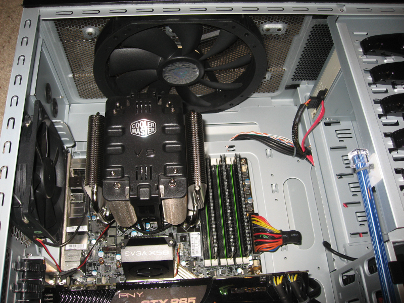

is your top fan a 230mm fan?
any chance you can give a pic of the inside of your rig while its on?

@DST4ME - I know I am late in responding, but... I don't have a pic of the top with the system on, but here's one with it off in case it helps:
HAF932%20Case%20-%20Looking%20up%20at%20the%20top%20fan%20with%20the%20system%20powered%20off.

  Quote DST4ME Quote  Post ReplyReply bullet Posted: 08 Mar 2009 at 7:38pm
THX keithwc, I was trying to see if you have 6 led fans or not. honestly I got nothing to add to what Alex said, cause he said it all.
the case is setup for best cooling, if you reverse it the most difference you might see is like 2c-4c degrees which as I stated earlier is nothing.
If your system temps are below 85c then you are good to go and should not worry about which way the fan it
