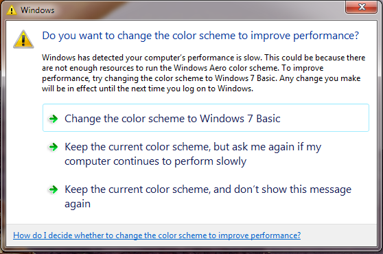

I re-seated my video cards, so let's hope that fixes my Windows error that "your system is running too slow".
copen View Drop Down
Joined: 02 Dec 2010
Posts: 112
  Quote copen Quote  Post ReplyReply bullet Posted: 08 Oct 2011 at 12:19am
Bah, I still get this error. Crysis Warhead, about 3 minutes of gameplay, and it forces me out of fullscreen to deal with this dialog:

  Quote copen Quote  Post ReplyReply bullet Posted: 08 Oct 2011 at 12:43am
Here's a hack around this issue: at least for games I know it fails on beforehand, I can mark those EXEs as "don't use Aero":
http://tr1x.com/how-to-disable-color-scheme-error-message.html

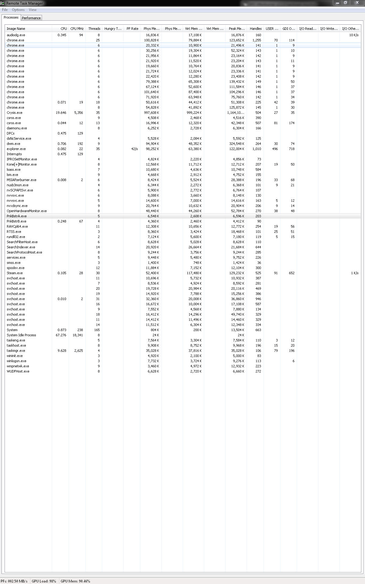

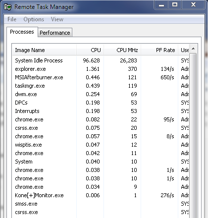

DST,
61 processes, 693 threads, 15022 handles. Here's a screenshot of the background processes while I typed this post.
  Quote DST4ME Quote  Post ReplyReply bullet Posted: 08 Oct 2011 at 2:44am
whats the deal with remote task manager?
give us a view of all those processes and have the memory they are using visible also.

  Quote copen Quote  Post ReplyReply bullet Posted: 08 Oct 2011 at 11:25am
That's just a tool I wrote, similar to taskmgr, but customized for how I like it.
Here's a snapshot of the top processes sorted by CPU mhz used, after cold boot, having Steam & Chrome started up.

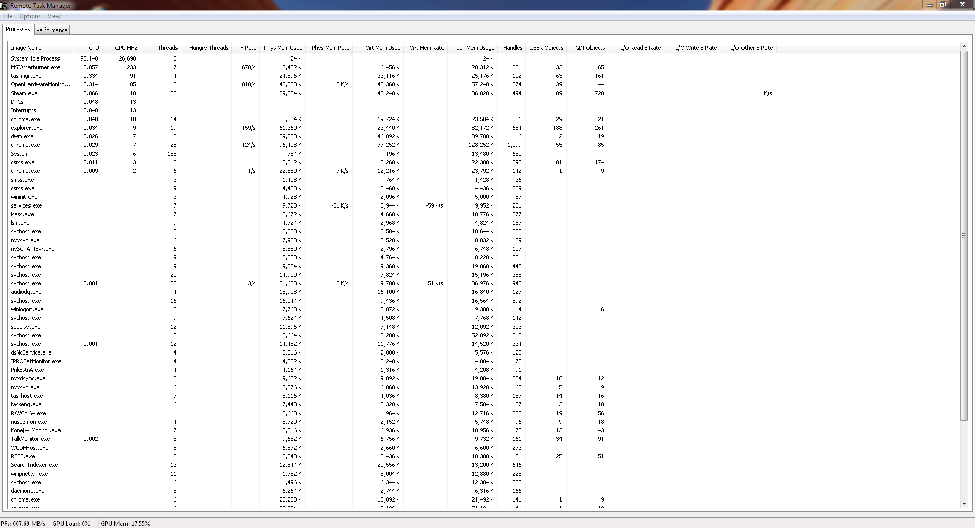

  Quote DST4ME Quote  Post ReplyReply bullet Posted: 08 Oct 2011 at 3:50pm
copen that screen shot is great but I need 2 things please.,
1. it get cut off at the bottom, I don't get to see all processes.
2. please sort them by name then post the screen shot.
3. also please use the pc as you would before you get windows telling you that you are short on resources, I need to see everything that is running on the pc when you get that error.
Edited by DST4ME - 08 Oct 2011 at 3:51pm
Joined: 02 Dec 2010
Posts: 112
  Quote copen Quote  Post ReplyReply bullet Posted: 08 Oct 2011 at 4:55pm
DST,
No problem. It forces me to the desktop under crysis within 90 seconds, so here you go:

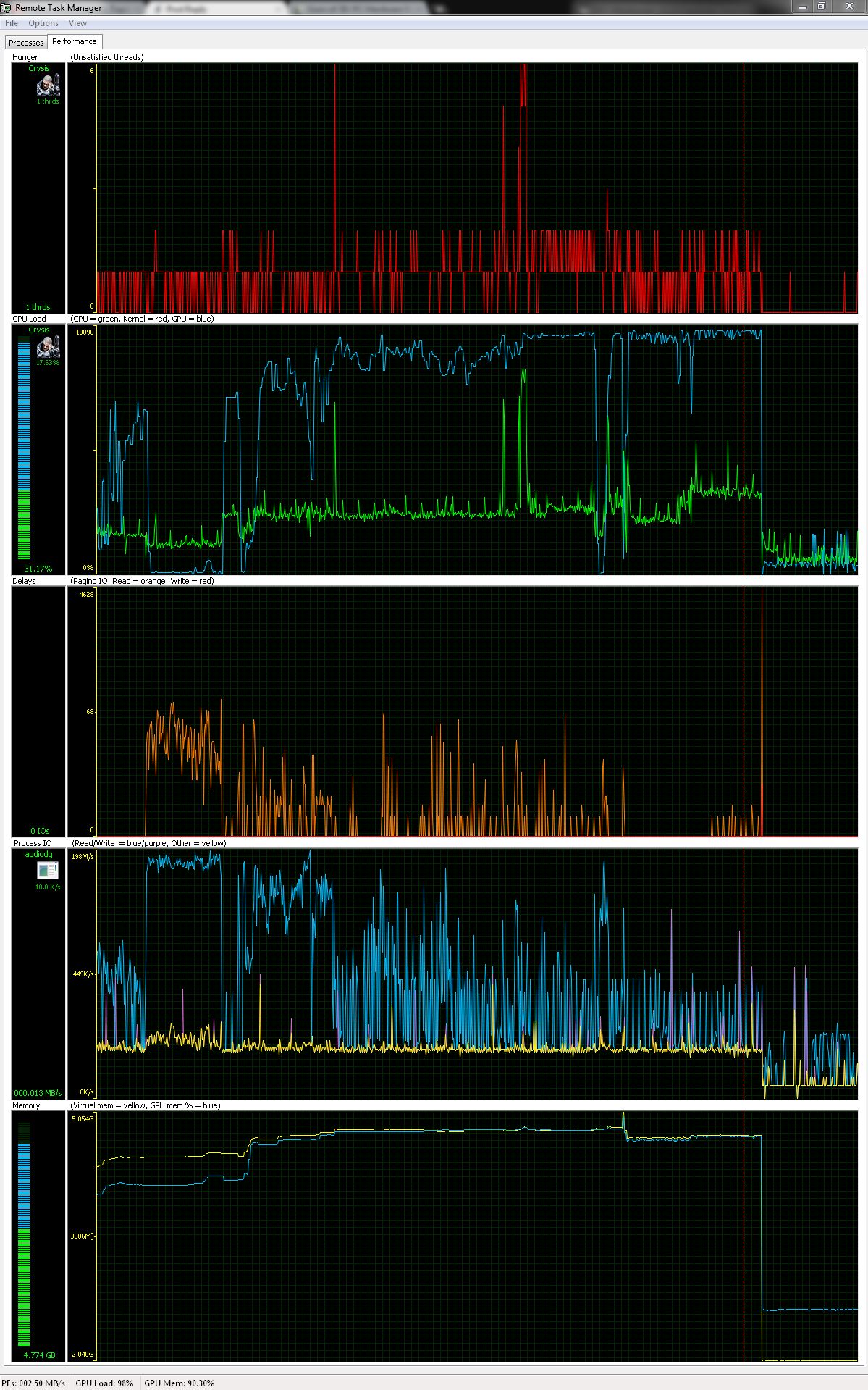

Joined: 02 Dec 2010
Posts: 112
  Quote copen Quote  Post ReplyReply bullet Posted: 08 Oct 2011 at 5:08pm
DST,
Here is a graphical representation of my system at that time as well. You can see that the GPU is quite loaded, but only perhaps 2 CPU cores are loaded.
Plenty of RAM for the system left (half), but only 10% GPU memory left.
Edit: I think the forcing to desktop happened where you see the blue GPU memory reached 100% (top of graph). So Windows must monitor the amount of GPU memory available, and when it's 0, it gives this message.
Edited by copen - 08 Oct 2011 at 5:12pm
  Quote DST4ME Quote  Post ReplyReply bullet Posted: 08 Oct 2011 at 7:26pm
You are getting that the pc performance is low, this means it has to do with system resources.
your first problem is chrome, your system is running extra 14 apps which all happen to be chrome, its a resource hug.
try using a different browser like opera or ff, I have opera open with over 50 tabs and am using less resources then you are with chrome and 14 tabs.
you have superfetch enabled or disabled?
