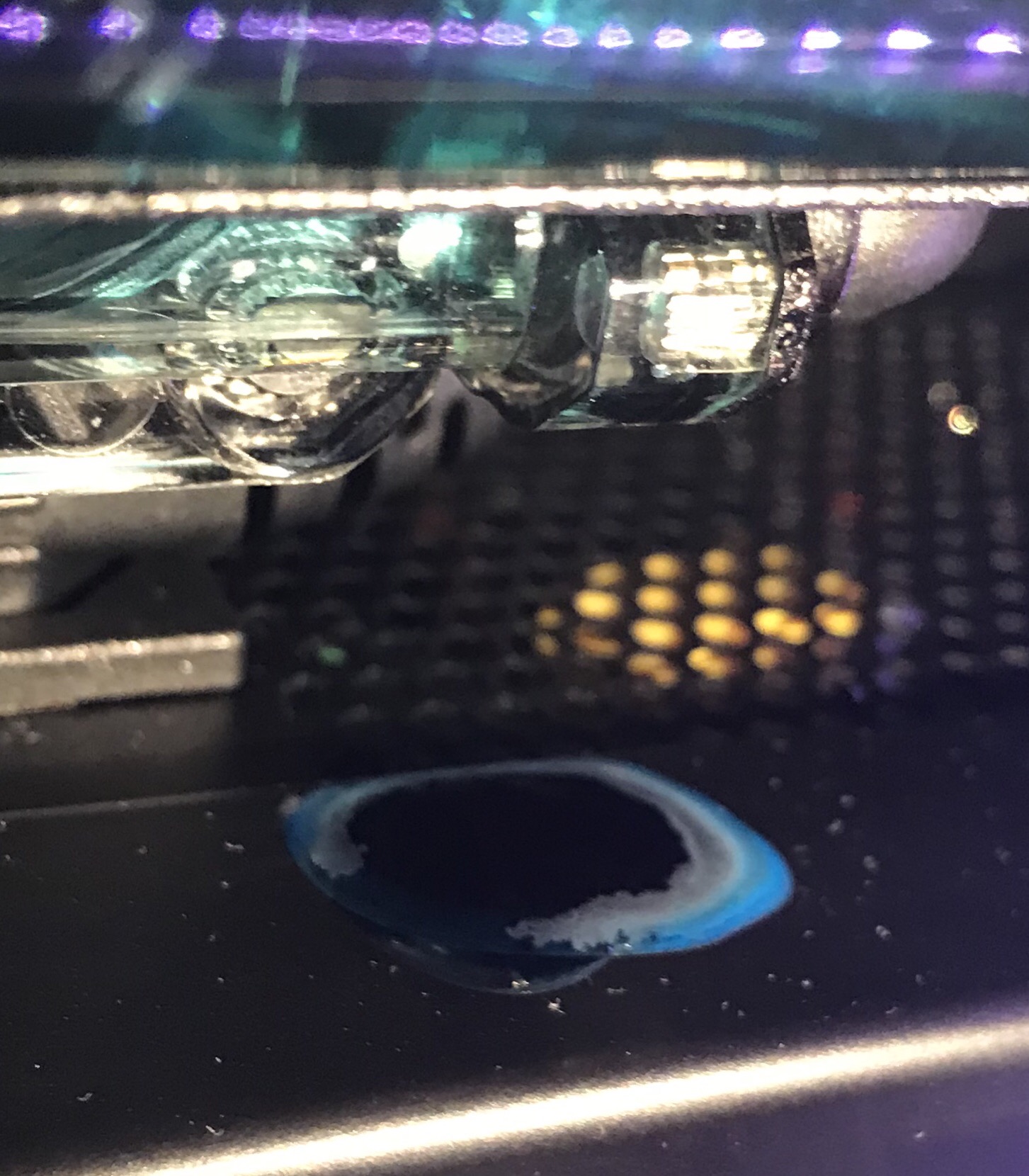

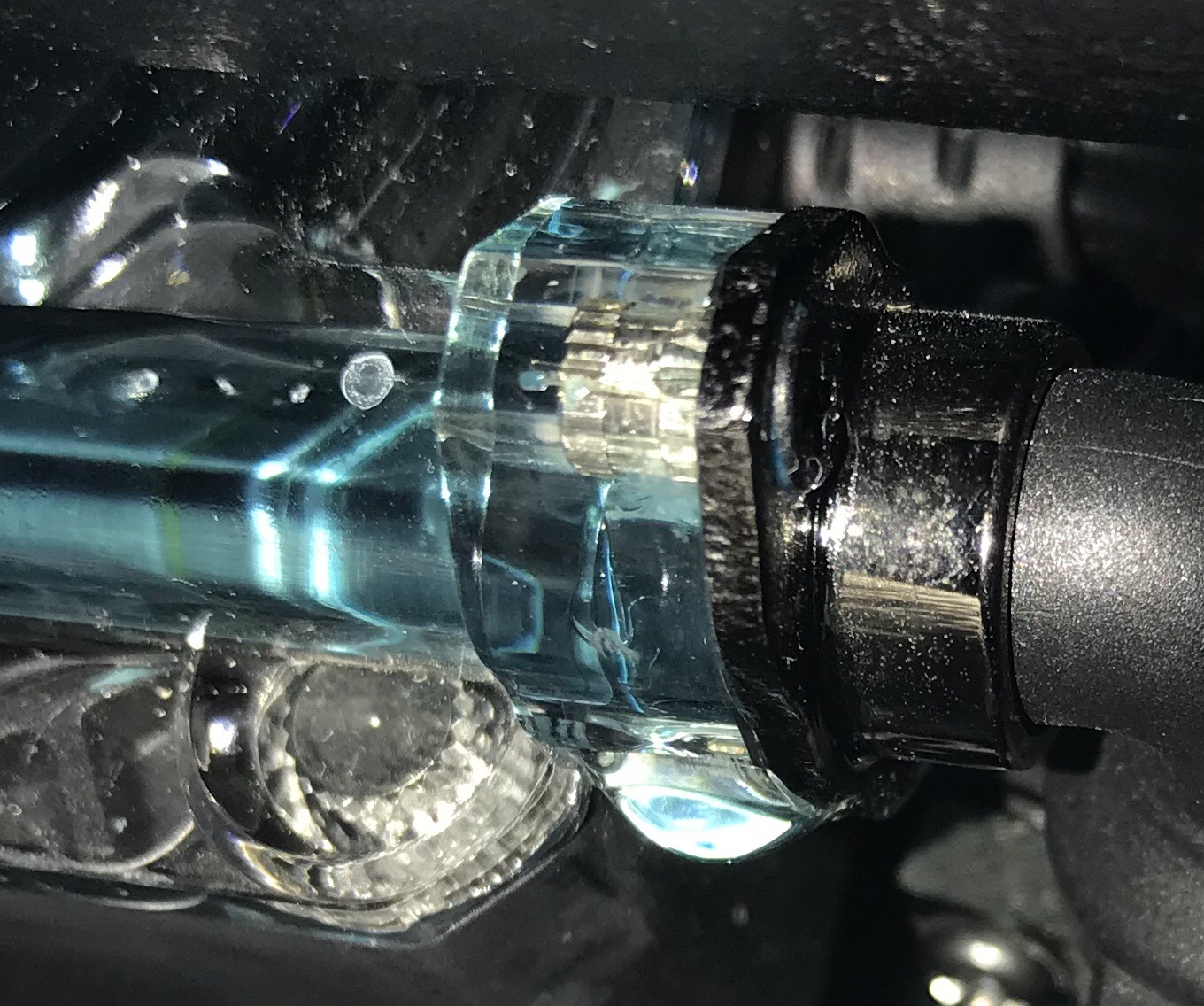

I have a Bolt X with hardline tubing. It leaked the first time I got it and sent it back to get it fixed. It’s leaking again in around the same area and it’s driving me crazy. I live on the East Coast so I figured I might as well try to learn how to fix these things now cause sending it back to California to get it fixed is too much. I messeged support, but want to see some comments here for good measure.
I’m not sure if this is related, but both times before I noticed the leak I heard a loud bang sound coming from the side of the room with the computer. Also, am I not supposed to put my PC on the same table as the rest of my set up?
Here are some pictures.

I can’t tell by the pics where the leak is, but if it’s a fitting then the fix should be relatively easy. If it’s a crack then a swap is needed. Hardline does make the work harder. Hardline looks great but has its disadvantages.    I’d consider swapping to flex hoses.

The pics are too close to the leak and there are what appear to be cracks but could be the view. Is that the gpu?
The loud noise could be the acrylic cracking. Hope not. Sad

It seems like the leak is coming from where the black tube connects to the bottom part of the reservoir. I can't see that area but when I feel it with my finger that's where the most wetness is. Can this be fixed by just tightening something?

Acrylic cracks if the metal fittings are over tightened or any other reason it feels like.  It doesn't crack with a loud bang but whatever made the noise might have or really just bad coincidence. Don't have experience with that type of cooler so can't tell you how everything connects. It looks like there are screws holding the fitting to the block but can't tell. If there are, you might want to see if the screws are tight, very gingerly (just thumb and finger, not hand), you don't want to crack it.
Maybe you want to loosen  the screws holding the fitting a little and move the elbow back and forth carefully to seat the o-ring and re-tighten, again, just with fingers holding the tool. Can't think of anything else. Good luck. Let us know what you do.
