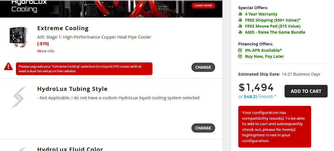

While I'm sure many people do build PCs with that CPU and air cooling, it actually seems Digital Storm will not let you check out if you select a i5-12600K and "Air Stage 1" cooling.
Perhaps it's possible to contact DS and request that they let you get it anyway, but I assume if they set the config up this way they'd strongly advise against it.
Edited by daveyd - 17 Dec 2021 at 9:05pm

You CAN select the single fan AIO, and for $30, it's not a budget-breaker. The Alder Lake chips handle power management differently from previous generations, allowing longer stretches of max turbo, at pretty high loads (= higher temps). I would not question DS's recommendation if they insist on the dual fan config. It's not a place to skimp.
Great work checking on that.
