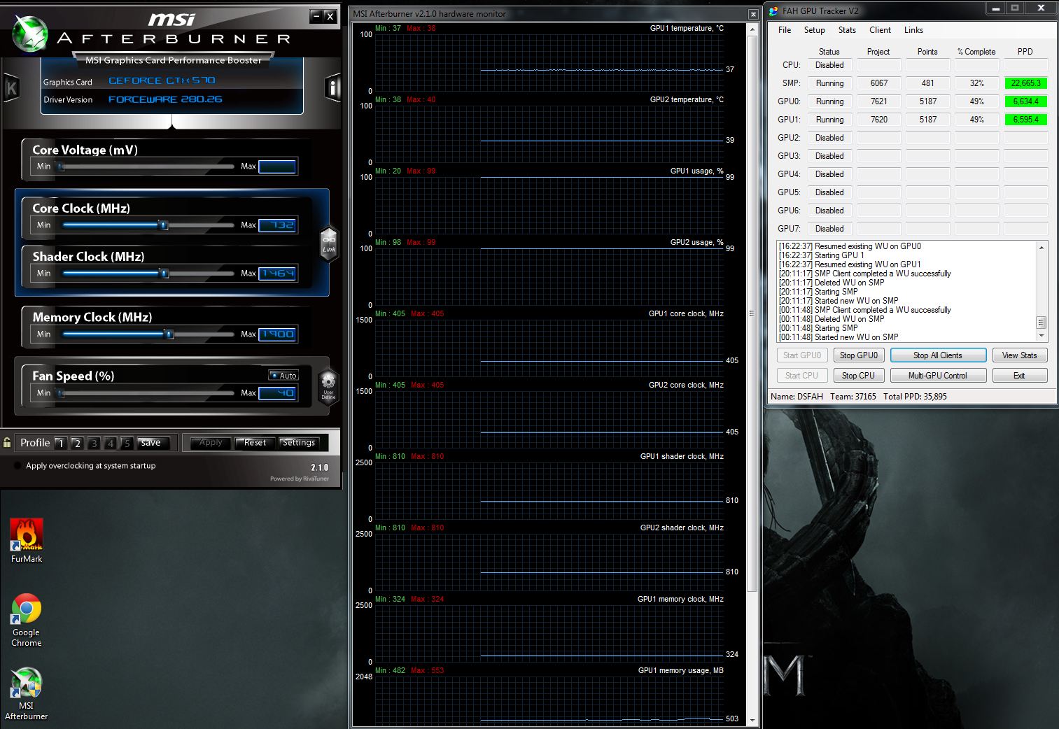

okay, how long should it take for the PPD boxes to turn green? ive let it sit there for like 10 minutes at stock settings and it looks like nothing happens. the % Complete is 0 for both gpus and the PPD reads 0.0. In afterburner the GPU usage for both cards is at 99% but the core clock for both is only at 405 (max 732). Thank you for your help!
  Quote DST4ME Quote  Post ReplyReply bullet Posted: 15 Oct 2011 at 6:27pm
it does take a while so lets see what the status viewer says.
the fact that they are 405 tho is not a good sign, they hay have down-clocked.
you watching your temps? if so what is the max so far?
Edited by DST4ME - 15 Oct 2011 at 6:28pm

Does this help?
http://imageshack.us/photo/my-images/163/ochelp.png/
  Quote DST4ME Quote  Post ReplyReply bullet Posted: 15 Oct 2011 at 9:54pm
I can't see that image its been resized, can you post the forum thumbnail code here instead?
but from the little I could tell from fah, looks like you are at 2% so its moving, it goes slow, but let it keep going, it will take a few hours.
I like to see your afterburner stats, can you give me a big image of that, just upload here instead, do you know how to do that?

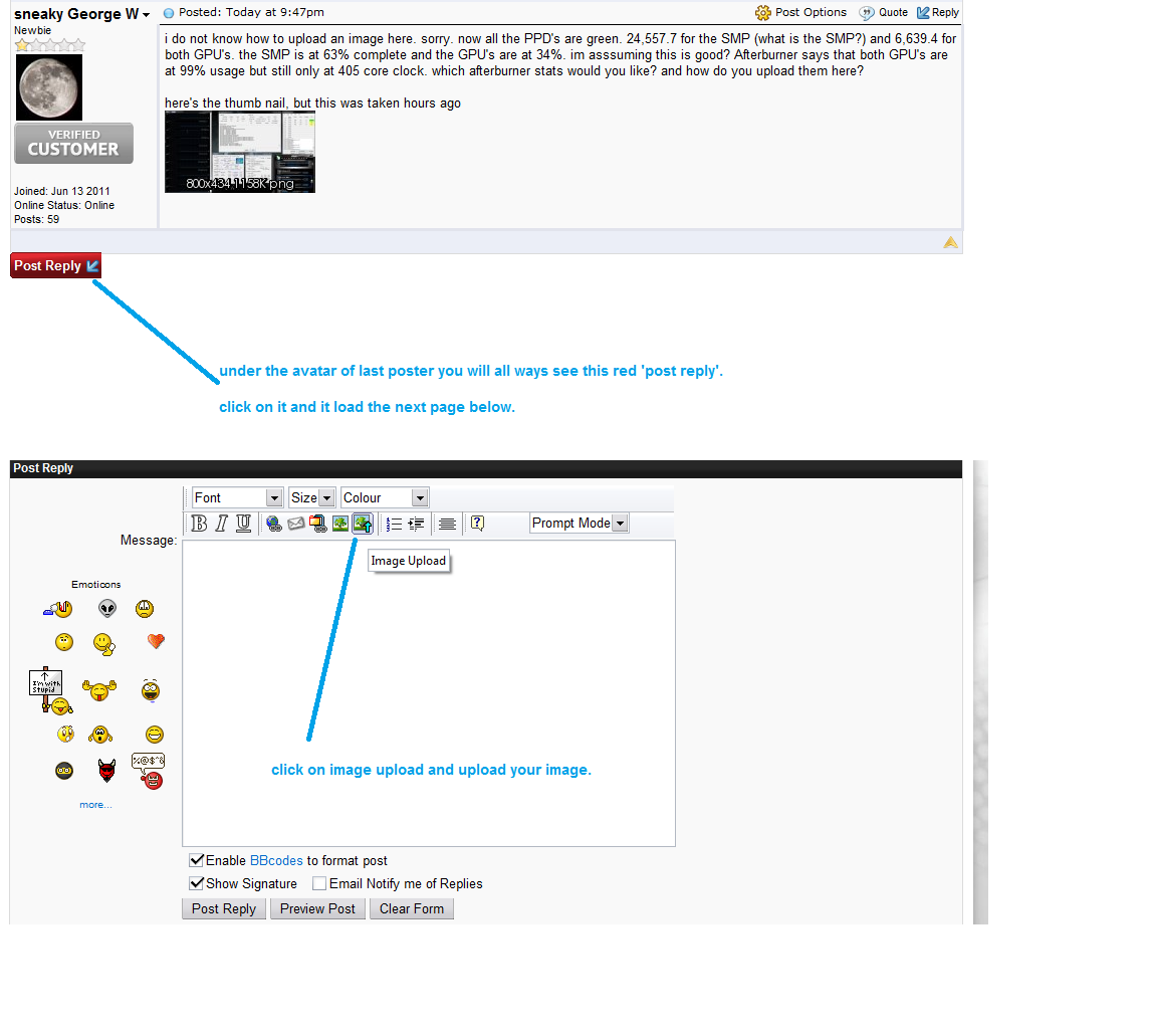

  Quote sneaky George W Quote  Post ReplyReply bullet Posted: 16 Oct 2011 at 12:47am
i do not know how to upload an image here. sorry. now all the PPD's are green. 24,557.7 for the SMP (what is the SMP?) and 6,639.4 for both GPU's. the SMP is at 63% complete and the GPU's are at 34%. im asssuming this is good? Afterburner says that both GPU's are at 99% usage but still only at 405 core clock. which afterburner stats would you like? and how do you upload them here?
here's the thumb nail, but this was taken hours ago
  Quote DST4ME Quote  Post ReplyReply bullet Posted: 16 Oct 2011 at 1:08am
if your clock is at 400 instead of your 700 then the gpus have down clocked.

Update: quiting FAH and trying to run Heaven and FurMark resulted in the same thing: 99% GPU load but only 405GHz clock speed.

Update #2: Rebooted and enabled SLI, heaven and furmark DID take both GPU's to 732. havent tride FAH yet.

Update #3: FAH started, PPD still in yellow but afterburner reports that GPU's are at 732 each.
  Quote DST4ME Quote  Post ReplyReply bullet Posted: 16 Oct 2011 at 3:55am
Ya I see your gpu downclocked, you had to restart to get them back to full clock.
you can run fah again, this time its should go twice as fast. keep eyes on temps.
