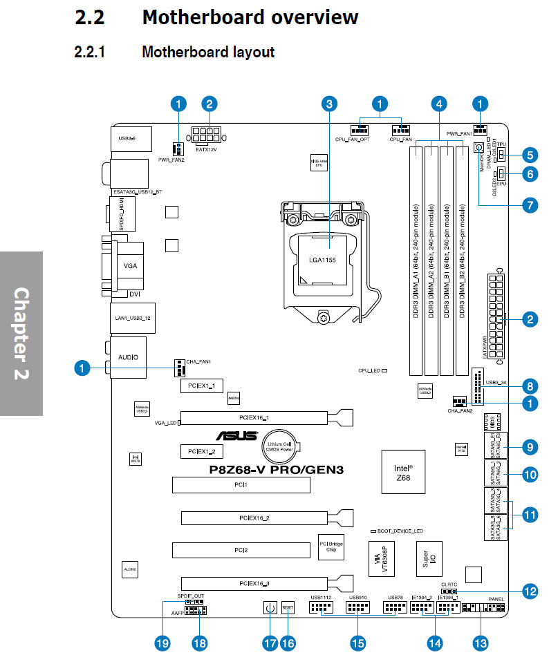

A question for you guys: Where does the H80 plug into the motherboard? Looking at the diagram above,on the top of the motherboard there are 3 headers suitable for fans: CPU_FAN_OPT, CPU_FAN and PWR_FAN1. The chassis fan on top is plugged into one of the CPU outlets, the fan originally plugged into the top of the H80 is plugged into the PWR_FAN1 and that should leave an open port unless the H80 is plugged into one of them? I found a PDF H80 installation guide from Corsair on their website and it does not show where the cooler block plugs in.
Thanks,
J.
Edited by jseidel - 24 Feb 2012 at 3:03pm

  Quote bprat22 Quote  Post ReplyReply bullet Posted: 24 Feb 2012 at 4:48pm
I don't t have the h80, but I believe the h80 pump body should be plugged into the Cpu_fan connector, top right of mobo between the Cpu_fan opt and pwr_fan header.   The other option would be to psu peripheral 4 pin plug.    Should be easy to trace from pump, unless blocked.    Forget the psu connection. I would think the Bios would need to sense the pump thru mobo.

1. The H80 should be plugged into the headers labeled CPU_Fan or CPU_Fan_OPT and not the case fans. That was one of the issues I had with my system is they plugged one of the top case fans into one of those ports and I kept getting error tones when I booted my system up.
The issue is those two specific ports are designed for CPU coolers only because they have an extra pin to read and control the fan speed. Case fans are not designed to have their speed change based on the CPU temp like a CPU cooler does.
That results in an error during start up because the BIOS is not receiving the correct reading from the fan. DS likes to improperly use those ports then make changes in the BIOS to ignore that error which they should not be doing.
I rewired my fans properly and have my two top case fans plugged into the PWR_FAN2 and CHA_FAN2 ports respectively. CHA_FAN2 is on the right side of the MOBO just above the graphics card.

OK, I decided to bite the bullet. I took off the inner fan to see if I could reach the CHA_FAN1 header with the fan out of the way. Still just out of reach to put the connector on without possibly doing some damage. So, after seeing how easy it was to remove the fan from the radiator I decided to take the whole thing apart since I had a new fan anyway that I wanted to put the back. With the radiator out of the way I plugged the new fan into the PWR_FAN2 header in the upper left corner of the board since I could reach anything I wanted with H80 radiator and fans out of the case.
Put everything back together and all is well. Both fans are now plugged directly into the motherboard and spin full speed. The CPU is running at 26D Celsius which is barely above ambient temperature. I may have to check the CPU for frost formation.
Thanks to everyone for their comments and suggestions.

The noise with the back fan plugged into the power fan header on the Mobo was too loud. Sounded like a jet taking off all the time. After doing some more reading I found my theory that the noise coming out of the back was from the H80 radiator was wrong. The noise was merely from the fan being attached directly to the case and going full speed. So, I took the back fan and radiator off once again so I could physically get to the plugs on the motherboard and put the outside fan connected to CHA_FAN1 as shown on the diagram above. What a difference in the noise level. I went into Asus Fan Xpert and now I see at that setting the outside case fan (Which shows as Chassis Fan 1)is going at about 1,300 RPM. Going with the other power fan monitor it was doing about 1,900 to 2,000 RPM plugged into the PWR_FAN2 header. What a difference it makes. The constant whine is gone and the noise level is fine for what I would expect from a well cooled high end system. FINALLY I am a happy camper!
