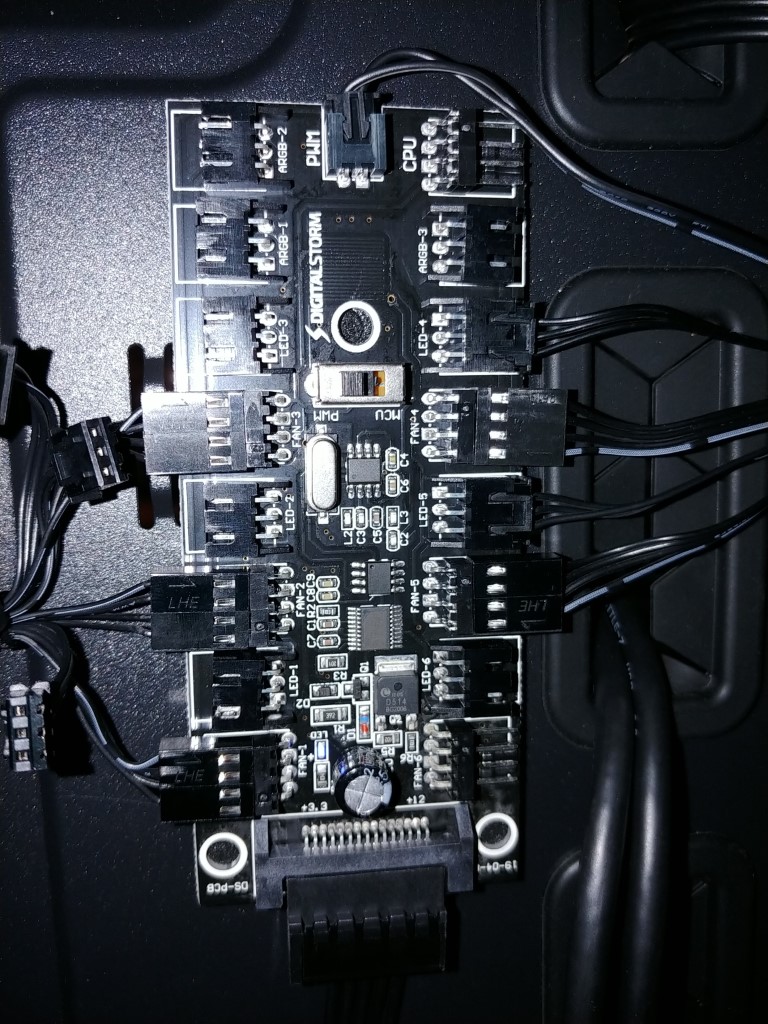

TL;DR: Got a second hand PC with a Digital Storm fan controller and 5x 3pin (NOT pin_blank_pin_pin) RGB Cooler Master fans (look just like MF120s) and no remote. The motherboard only has 4pin (12v,RGB) headers. What are my options to control the fan lighting? The 3-pin connectors don't seem to match any industry standard RGB controllers.
I've been building PCs for 23 years but I've never really been into RGB stuff, so this is my first encounter with RGB fans.
I got a smoking deal on a budget PC a couple weeks ago. It came with an Asus Prime B460M-A in a "Redux" branded Cooler Master TD500 with 5x matching CM RGB fans.
There was no remote included with the PC and the motherboard only has 4pin (12v, R G B) headers, while the fans (which look like MF120 Halo fans) each have a simple 3 pin connector (NOT the pin_blank_pin_pin ones). They were all connected to a Digital Storm fan controller board on the back of the case which gives them a constant rainbow effect. I disconnected the 3 front fan LEDs for now, and I took a picture of the controller. You can see the 3pin fan plugs loose on the left side:
Does anyone know what I can use to control these? I have a feeling this thing originally had a remote, but I have no idea if it's possible to get a replacement. I also realized more recently that the fan controller starts acting up if I connect more than a couple fans so I may end up replacing it anyway... but I'd really prefer to replace it with something that could control the RGB as well.

Thank you for the input. Since the DS controller's PWM portion has problems anyway I was hoping someone would know how to use these fans with a different (non-DS) RGB controller. I don't think DS is likely to be much help with that, and I also have no way to get the original receipt for the PC. I will try contacting them though.
If anyone is familiar with this style of fan or adapting them to work on a standard store-bought RGB controller I would love to know what my options are.
In the meantime I will just use PWM splitters from the motherboard to control the fans and leave the RGB disconnected. If I can at least find a remote that would be an okay solution (at least as long as the remote stays working).

Also, I too have only recently dealt with ARGB. Addressable RGB is interesting/nice, though also a mess because (of course) companies want to coerce/force you to stay in their ecosystem (i.e., software compatibility limitations and various connectors) -- basically, no practical standard.
Following a lot of Web searches:
Could they be Thermaltake Riing fans?
Apparently, this is referred to as VDG. Confusing/annoyingly, VDG is the same voltage, data, ground configuration as ARGB but in a more compact connector/header (i.e., there's no pin spacer). Get ready to face palm harder as the connector has also been labeled DRGB/D-RGB (Digital RGB).
Hopefully, this will provide a tiny bit of clarification/insight:
I need a little bit of aid connecting my VDG | Linus Tech Tips (Forum)
You could try the TT RGB Plus software.
On the hardware side, I was not able to locate a compatible cable/adapter -- they had the wrong male/female ends.
Thermaltake does have the TT Sync Controller. However, I cannot verify what fan connectors it supports.
P.S. Corsair appears to be repurposing a legacy connector/header.
Corsair RGB connectors are NOT proprietary! | Solarity Technology (YouTube)

https://www.amazon.com/Cooler-Master-Controller-3-Pin-Ports/dp/B07Z7WLWD5
