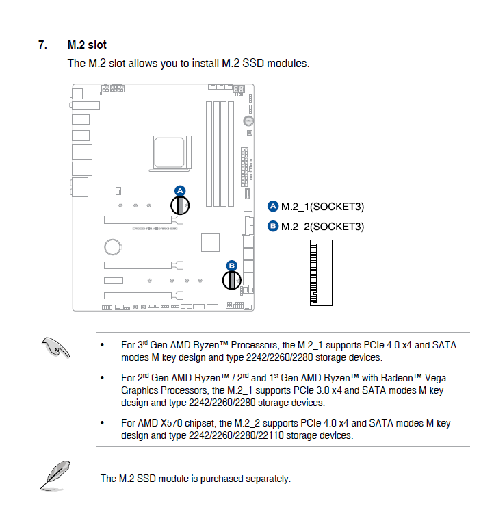

As far as storage capacities, I leave that up to others to know their needs. However, there is one issue I see. "Storage Set 2" you have chosen a FireCuda 520.
1) A limitation of consumer level boards and CPUs, only one M.2 slot (the one connected directly to the Ryzen) supports PCIe gen. 4. The second slot (via the chipset) is PCIe gen. 3. So, the FireCuda 520 or any other gen. 4 SSD will be crippled in the second slot. Basically, only pick up to one gen. 4 SSD.
I would suggest the 970 EVO Plus for the second drive.

Good to know. Can you clarify for me for my final build? I ended up switching to the Dark hero motherboard at the last minute with the 5600x cpu. Board Specs are unclear to me as they mention two m2 pcie 4 and one pcie 3 but then claim 2 in total so am I un clear if I am limited to one 4 and one 3? Internet searches are also unclear. I still have time to change things by phone even though I placed the order.
Foremost, I will admit, I stand (err sit) corrected. I can't find proof as of when the change took place, but Im guessing one of the AMD AM4 AGESA updates. That could be also be why your Web search results are confusing/conflicting. Nevertheless, my bad for not carefully recheckiing recently.
If you look at the board specs....
ROG Crosshair VIII Dark Hero - Technical Specifications
Storage
AMD Ryzen™ 5000 Series/ 3000 Series Desktop Processors :
AMD Ryzen™ 4000 G-Series/ 3000 G-Series/ 2000 Series/ 2000 G-Series Desktop Processors :
1 x M.2_1 socket 3, with M Key, Type 2242/2260/2280 (PCIE 4.0 x4 and SATA modes) storage devices support
1 x M.2_1 socket 3, with M key, type 2242/2260/2280 storage devices support (SATA & PCIE 3.0 x 4 mode)
AMD X570 chipset :
1 x M.2_2 socket 3, with M Key, Type 2242/2260/2280/22110(PCIE 4.0 x4 and SATA modes) storage devices support
8 x SATA 6Gb/s port(s),
Support Raid 0, 1, 10
This is a little confusing. It might have been less if ASUS listed them as...
Storage
AMD X570 chipset :
Anyway... To break it down.
If you look at photos of the board, M.2_1 is between the CPU and and top PCIe slot, beneath the cover with the Dark Hero name printed, which doubles as a heatsink. This is where DS will/should install the fastest drive (e.g., Samsung 980 Pro).
AMD X570 chipset :
M.2_2 (with heatsink cover) is located above the bottom PCIe slot.
Again, I do apologize for the misinformation. As you can, hopefully, deduce based on the details I provide, I'm very anal about my research. Do I make mistakes occasionally? Yes. However, I think, this was AMD/ASUS sneaking one by me.
With all of that said... I still recommend your drive configuration. The 970 EVO is plenty fast.

Interesting.. I have double 980s on my Dark Hero. I'll dig up a drive performance app and test them and see what the delta is between the two.
MrCheetah View Drop Down
Joined: 09 Mar 2021
Posts: 392
  Quote MrCheetah Quote  Post ReplyReply bullet Posted: 12 Apr 2021 at 4:53am
@ealderson I am indeed curious if somehow I misread it many times. Granted, specs listings can be confusing, but I recheck a lot. Also, I would say I was perhaps a bit less careful on the Dark Hero (as I had done a lot more research for the X570-E Gaming due to my own interest in builds with that board), however, that spec has changed for the X570-E Gaming as well. Again, possible I'm simply mistaken, though I have doubts.
ealderson View Drop Down
Joined: 12 Feb 2021
Posts: 142
  Quote ealderson Quote  Post ReplyReply bullet Posted: 12 Apr 2021 at 5:02am
That could definitely be the case...you certainly researched it more than I did before I bought it. :)
I ran Samsung Magician benchmarks since I already had it installed and here's what it threw out:
980 Pro 1 (OS Drive) - Sequential 6541 MB/s Read, 5169 MB/s Write; Random IOPS 350097 Read, 308593 Write
980 Pro 2 (Game Drive) - Sequential 7094 MB/s Read, 5198 MB/s Write; Random IOPS 371826 Read, 335937 Write
Just for comparison's sake; my storage drive (860 Pro)
860 Pro (Storage Drive) - Sequential 550 MB/s Read, 488 MB/s Write; Random IOPS 55908 Read, 47363 Write
Edited by ealderson - 12 Apr 2021 at 5:03am
Joined: 12 Feb 2021
Posts: 142
  Quote ealderson Quote  Post ReplyReply bullet Posted: 12 Apr 2021 at 5:15am
Ah...details page should help.
Drive 1 - Interface PCIe Gen. 4 x 4
Drive 2 - Interface PCIe Gen. 4 x 4
Drive 3 - Interface SATA 3 (6Gb/s)
Joined: 12 Feb 2021
Posts: 142
  Quote ealderson Quote  Post ReplyReply bullet Posted: 12 Apr 2021 at 5:37am
This might also help - from the manual.
  Quote Cretae Quote  Post ReplyReply bullet Posted: 12 Apr 2021 at 5:42am
As I understand it, the board delivers 24 PCIe lanes. 16 go to the GPU, the next 4 are dedicated to NMVe M.2 slot 1, and the rest go to the chipset. NMVe slot 2 works off the chipset lanes, but there is often not much competition that would create a noticeable difference in performance from slot 1 results. It's curious that slot 2 results here are faster than slot 1. My theory is the differences in data being read/written/transferred. The OS has vastly more choices and subroutines to process than with the slot 2 drive just feeding a game to the CPU. That's my story, I'll stick to it for awhile 'til you guys blow me up.
I was blathering while the diagram was being posted. As I see it, it's explaining that the chipset installed on this particular form factor MUST be X570 in order to enable PCIe 4 on slot 2.
Edited by Cretae - 12 Apr 2021 at 5:48am
