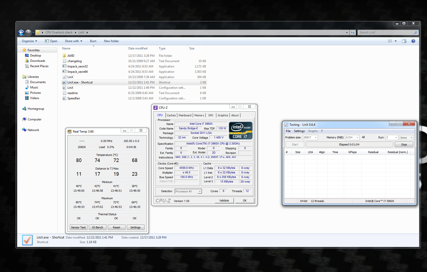

Is this a good temp and voltage?

  Quote Alex Quote  Post ReplyReply bullet Posted: 22 Dec 2011 at 6:42pm
Before anyone responds, don't forget, this is not a P67 or Z68 system with four cores. We're talking about a much more power intensive and hot platform. Based on the 3960X CPU (all new six-core) systems require more voltage than the standard P67/Z68 counter parts. They will also run a lot warmer. In addition, due to the extra cores, it is more difficult to get stable at higher speeds without increasing CPU voltage and heat as a trade off. Doing 4.6GHz on a 990X would be very, very difficult, but, it can be done with the X79 chipset.
Anyways, in regards to temps and voltages, you are in acceptable ranges, if you would like, you can fine-tune the overclock higher by lowering the voltage on the CPU and seeing if your system is stable, or pushing your CPU faster with a extra bump on the CPU multiplier, however, please note, your voltage regulators will get extremely hot, and they can burn out and kill the board if your system is pushed too high.
  Quote DST4ME Quote  Post ReplyReply bullet Posted: 23 Dec 2011 at 6:18pm
As long as temps are under 85c its fine, but at your vcore (1.48) you can expect to fry that cpu wihin a year and a half, and if you have teh DS 3 year warranty (1 year parts) then you have to pay for it.
  Quote Alex Quote  Post ReplyReply bullet Posted: 23 Dec 2011 at 6:29pm
I disagree, you will not fry the CPU at 1.48v. We would never configure a system that would do that after that time frame. From our experience from testing so many systems, and from actual people that work with overclocking CPUs, even 1.5v is fine for a long time as long as the CPU is cooled properly. Don't forget, this is a 6 core CPU, not a 4 core. You're spreading that voltage to six units.

After the holiday I am going to call Digital Storm and talk to them about turning the overclock down some. What voltage would be good for the 3960x?
  Quote Alex Quote  Post ReplyReply bullet Posted: 25 Dec 2011 at 4:35pm
1.48v is fine if you want that high overclock. If you want to lower the overclock, we can lower the voltage. You're best bet is to contact our team directly so they can help you with that.

ok I called and got the voltage down to 1.38v runnimg at 4.4GHz. One question I have is in the bios the voltage is set to 1.38v but when I use cpuz and cpuid hardware monitior they both say the voltage keeps jumping from 1.424v to 1.432v. Should I follow the bios settings or the programs?
  Quote Alex Quote  Post ReplyReply bullet Posted: 27 Dec 2011 at 2:14am
It's always going to change depending on the load. You should be perfectly fine.
