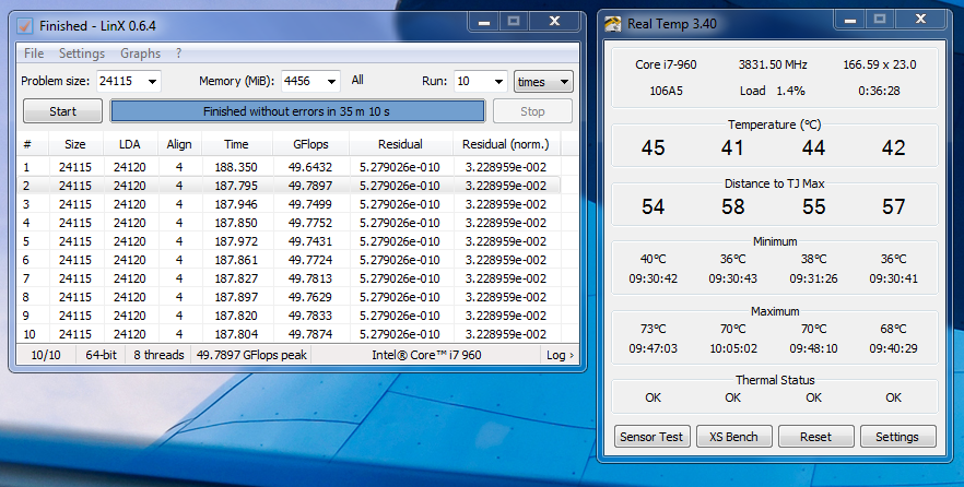

Passed Linx on ten passes with a 23x multiplier, so what next?  It won't let me put 25x is there some setting I should change or what?

  Quote justin.kerr Quote  Post ReplyReply bullet Posted: 12 Jul 2010 at 11:21pm
you should post your full BIOS settings, that way we can get you to 25 multi, and make sure you don't have any other issues. lol

Finished 10 passes of linx!

good progress, temps are getting up there, be careful when you do prime
  Quote justin.kerr Quote  Post ReplyReply bullet Posted: 14 Jul 2010 at 4:38pm
things are looking good... I would try for Prime95 now..
