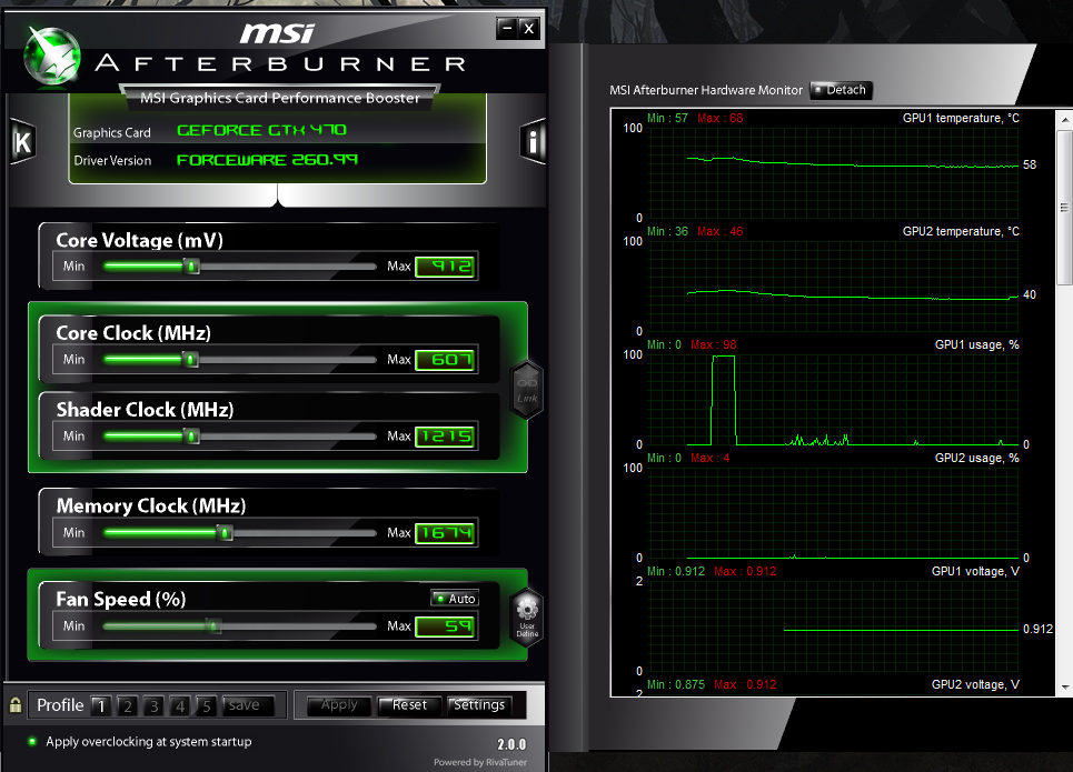

got SLI running. not to start overclocking the cards with afterbuner, i have to do each card independently? When i run Kombuster only 1 GPU is running at 99%
Here is what I have: The only change here is I made a fan profile
Edited by police215 - 30 Oct 2010 at 10:07am
Dragoonseal View Drop Down
Joined: 03 Apr 2009
Posts: 2247
  Quote Dragoonseal Quote  Post ReplyReply bullet Posted: 30 Oct 2010 at 10:22am
To use SLI games or Kombustor have to be running in full screen, not windowed.

  Quote justin.kerr Quote  Post ReplyReply bullet Posted: 30 Oct 2010 at 2:04pm
it will overlock both cards at once. make sure to use the multi GPU kombuster also
