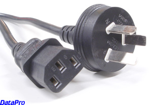

  Quote Bobby Quote  Post ReplyReply bullet Posted: 11 Oct 2012 at 3:45pm
Look in the back of your PSU and there should be a little (usually red) sliding switch that switches between 115/230 volts. Then you can either get a plug adapter as Tidgxor suggested or just buy a 230V power cord like this one. I used the power cord whenever traveling to that part of the world where 230V is common
