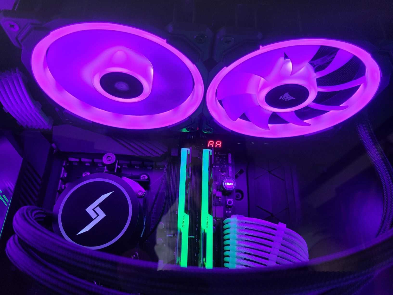

OK, new issue. This is kind of interesting so I wonder if anybody else has experienced it or can test it on their system and see if they can duplicate it. I have the DS AIO Stage 2 (dual fan) with Corsair LL fans and it appears to be attached to the CPU FAN header on the mobo. Whenever the cpu gets to the point where it calls for 100% fan all the fans kick up except the radiator fan closest to the front of the case. That one stops completely (pic attached). If I ratchet down the percentage RPM it calls for then it starts spinning again. I can duplicate it in Fan Xpert 4 or by changing the mobo fan settings in the BIOS and setting them to full speed. This doesn't seem normal to me since the cpu hitting a thermal threshold that calls for max fan RPM shouldn't cause one of the key fans to stop spinning and thus be effectively reducing cooling. Anybody have any ideas?

I went ahead and opened a ticket with DS since I am also able to replicate the issue when gaming or processing large files, etc. Anytime the CPU hits a thermal threshold and calls for max fans the other 5 fans in my case kick up to 100% RPM, but this front one comes to a complete stop. I double checked the header setup and it looks like they have both fans running off a splitter and connected to the CPU_FAN header. I was tempted to move one to the CPU_OPT header since there is nothing plugged into it, but will wait for some direction from DS before I dig into all their pretty cable management.

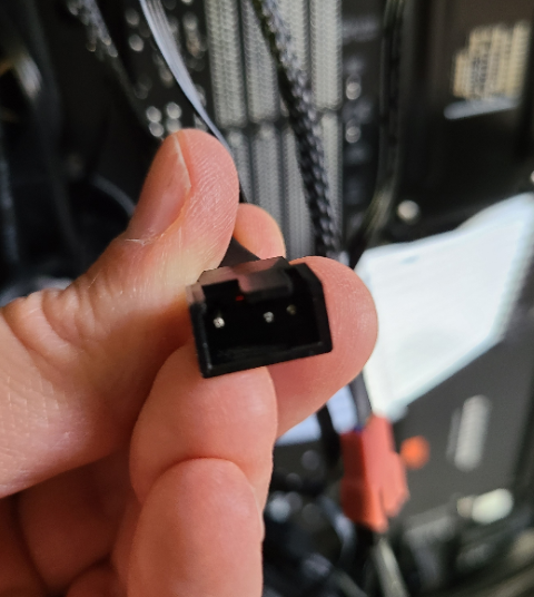

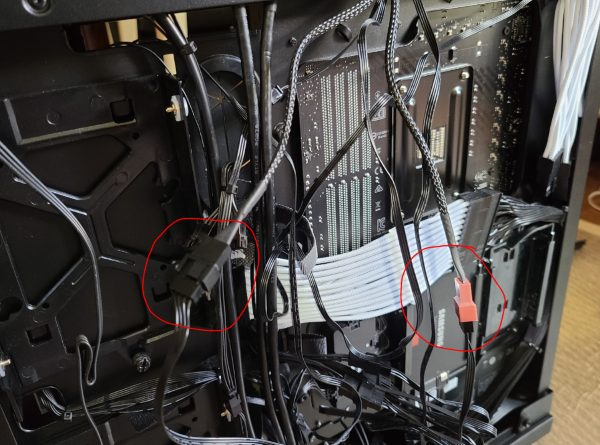

I decided to tear into it today and I think I figured out the issue. Just posting this in case it helps someone else. After removing the back and digging into the cable management (which involves cutting like 15 zipties ) I got down to what the fans were connected to.
The front AIO fan (problem fan) is connected to power through the black connector and the back AIO fan is connected to the red connector (below).

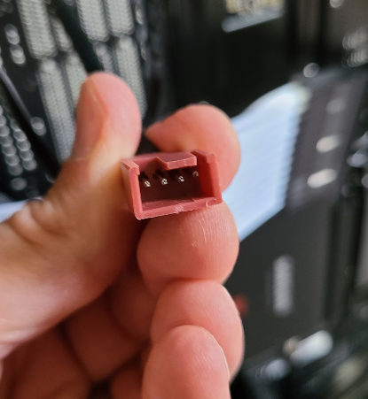

When I pulled the connectors apart I was intending to swap them just to see what would happen, but I noticed two things. One, that the working fan had 4 pins in the connector and the non-working fan only had 3. I figured that was the issue, but then I also noticed that the far right pin on the non-working fan was depressed a bit. Like it didn't seat all the way in the connector or was pulled out a bit by the tight cable management. I figured I'd try to push the pin up into the connector better and try again before doing anything more invasive and I think that seems to have fixed it.
Red Connector (good fan)
Black Connector (bad fan) - note pin on right not fully engaged/seated and pushed in
