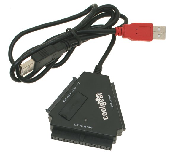

One thing I would recommend is a USB SATA/IDE adapter --- looks something like this......
Remove the old drive from your gateway and plug it into this unit, and the UBS into your new DS rig. The DS rig should recognize the old drive and you can move all the data you want without having to get into the OS on the old drive.
I was turned on to these things by bprat (who else?) when I was concerned for a boat-load of data (10 years worth) that I absolutely have to migrate to the new machine.

Oh hey, that could be just the thing I need! Thank you very much. I'll look into that for sure.

oh, and regarding the USB to IDE Adapter, now that I think about it, I have several old computers (pre-2000) that I'd like to look at. That adapter would probably work for those too. I'm hoping.

The adapters like the one above come in USB 2.0 and 3.0. If you have a serious amount of data to move, it might be worth the extra $5-$10 to get the USB 3.0 with the higher data transfer speeds.
*Edit... below...
USB 3.0 Sabrent from Amazon - $24.99
it's little brother, the USB 2.0 - $14.99
These two come highly reviewed and recommended.
