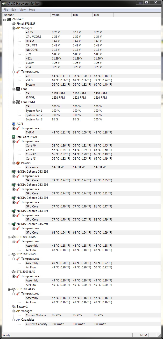

  Quote DST4ME Quote  Post ReplyReply bullet Posted: 04 Mar 2010 at 2:33am
what are your temps? give us a screenshot of HWMonitor while seti is has been running for a bit, make sure everything is visible.

  Quote Zain Quote  Post ReplyReply bullet Posted: 04 Mar 2010 at 12:44pm
Here is the output from HWM:
  Quote DST4ME Quote  Post ReplyReply bullet Posted: 04 Mar 2010 at 6:02pm
ya the 295s run hot specailly when you sandwitch them like that, which why I went LC, lower the temp room to 70c and make sure your gpu fans are set to run at 100%. You may lose a gpu or so because of the fan this way, but that is where the warranty comes in.
once they start going to 90c or higher then you might start to have problems, or you may not, the gpus are set to run at higher temps according to nvidia.
