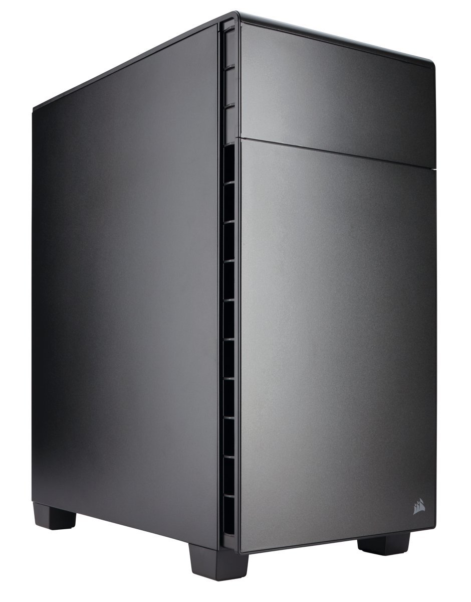

I have a few questions regarding the case and fans for the Slade system hopefully someone at DS or someone who owns the case can clarify.
First I would like to say to DS the While I think the Slade Info page (the one with videos and reviews etc.) is great but I would also like a more itemized spreadsheet like info page. I'm referring to the one you get when you click "more info" on a case inside the configurator. Problem is the case shown inside the Slade 2 configurator is not the same case. It shows the Corsair Carbide 400q which is a very different case. You may want to consider updating that area of the page as it gave me a bit of confusion.
First, I'd like to know if by placing fans on the inside of the side panel mounts will interfere with the video card, PCI cards or PSU?
If it does not leave enough room on the inside of the mounts can you place the fans on the outside of panel on the mounts? while still hiding the cords?
Second, can the corsair h100i 240 radiator be mounted inside the case venting out or only in? which areas can the radiator actually be mounted to vent out of the case just the top or can the front work as well?
Third, How many total fans can be mounted in the case (including radiator)? Also is the below airflow setup possible and is it the best way to do it (would DS do it this way):
2 intake fans on the front, 2 intake fans on the side, 2 exhaust fans on radiator at top and 1 exhaust fan in back?
Lastly, Does DS have any performance type fans that are non-LED and neutral colored (black, white) or is the only option the corsair fans with the red trim on them?

So which case are you referring to then?
Heat rises so the best config for a rad IMHO is always on top, because you don't want head in the case, so when the rad is on top, the head from the rad will exit from the top immediately and not go thru the system. The less heat in the system the better.
Depending on the case the rad can be installed in different places and if you have very good airflow then the head from it won't matter. As a rule I personally when I build system put the rad on the top with it blowing the air out.
Again I'm not sure which case you are referring to but if they can't do the side window fans then its more of an cutting the material issue rather then space issue from what I understand.
You can always request whatever fans you like to use if they are not in the config page, it will probably cost a little more to do so. But if you want good airflow then go with a case with good airflow off the bat, instead of spending extra $120 or so trying to make a case with less airflow have more.
Let me know the case you are talking about and I will answer your questions as far as fan placement. I think you are talking about the Carbide but I want to be sure.

No, I'm certainly not referring to the Corsair Carbide 400q which is not the case they are actually using in the default pictured Slade 2. I'm referring to the "noise cancelling" one. The one that is shown in the case video on the Slade info page when you select Slade but before the configurator. The page with all the flashy specs and reviews etc. It has no window, but a removable side fan panel.
The real Slade case is completely different. It has hidden side panels so no, its not about cutting any new holes. I'm asking about the space inside the case and clearance between the fan and the GPU and PSU.
I was planning on putting the radiator on the top, facing out as I was asking about in my "third" area in the last post. That is the setup I'm basically wondering if it will work. (IE will the space between the top of the case and motherboard allow it)(I'm assuming yes though)
I am aware of special ordering fans. I was asking a specific question of what DS offers and what the Corsairs fans actually look like (I.E are they red trimmed or is that just a default picture)
The rest of what you stated about the case price and airflow is irrelevant. The case they show in the Slade video is good airflow. I would name it better if I could find its name. The incorrect one is the Carbide which IS a worse case on airflow it would seem to me.
I appreciate your enthusiasm to quickly post in my threads but as I stated in my opening sentence in the OP I would like to hear from someone in DS with the knowledge of the case specs and can clarify the mismatch of cases or someone who owns a Slade build that can answer the question. Thank you.

The currant Slade does use the Corsair 400Q case. The Slade you are looing at in the Reviews are for the old Slade that used the Corsair 500D case.
I don't think the 400Q has the side fan option in the door for the Slade. The 400Q comes with a single 140mm fan in the front and a single 120mm exhaust fan in the rear. You can mount a AIO 240 rad in the top but a 280 or 320 has to be mounted in the front. The fans on the top can be arranged for intake or exhaust. You have to be careful not to have too much exhaust or you can create dust problems. DS can balance out your fans for the best configuration.
The only reason to pick the Slade case is for its sound damping. If you add a bunch of fans you will loose a lot of the quietness of the case.

Well, thank you Frank for the response and the case name. I looked it up from there and I think its actually called the 550d.
If what you say is true then this is EXTREAMLY disappointing news for me. The big flashy page and video showcasing the Slade case is basically a lie or to somebody who wasn't paying attention on the configurator page would get the ol' "bait and switch."
I thought the confusion was the other way around, meaning the 550d is what you get but the pictured 400q was wrong. This is a major problem.
The 400q is not nearly good enough. I was only interested in the slade for that case. That 550d case is in fact the only one I find appealing on the site. In another thread I said I had a thing for Silverstone cases or any case with a solid, heavy, not flashy case. This is the only suitable professional looking option IMO. My liking it has little to do with the sound dampening and that is certainly NOT the ONLY reason to get that case. To that point though I may be getting the DS hydrolux fan controller to automate the fan speeds when not needed at full speed. So I realize that filling the case up with fans is less silent but the case COMES with those slots, I'm just using all the ones I see available, not trying to mod the case or anything.
I'll state it again from the top. I would like to place the airflow like this:
* 1x 240 rad on top venting out with its 2 fans.
* 1x exhaust fan in back
* 2x intakes in front
* 2x intakes in side
That setup would have positive air pressure and good flow and basically what you both repeated, so I guess we are in no disagreement there. I wasn't asking about HOW to create good airflow as much as I was asking if that setup would work in the 550d specifically or if something would have to be changed to accommodate space, case design, etc.
...but if its the 400q that is the actual Slade case then all that is pointless because that is smaller sized and far less capable case and I will not be getting it.
I guess if what you say is true Frank then next I will have to see if DS has a few of the old 550d laying around they will let me use or something. I felt like I was getting close to a final config but this might send me back to step one.
*PS. Its EdgeCrusher, Frank, not EagleCrusher, that would be a crime against an endangered species. ;)
