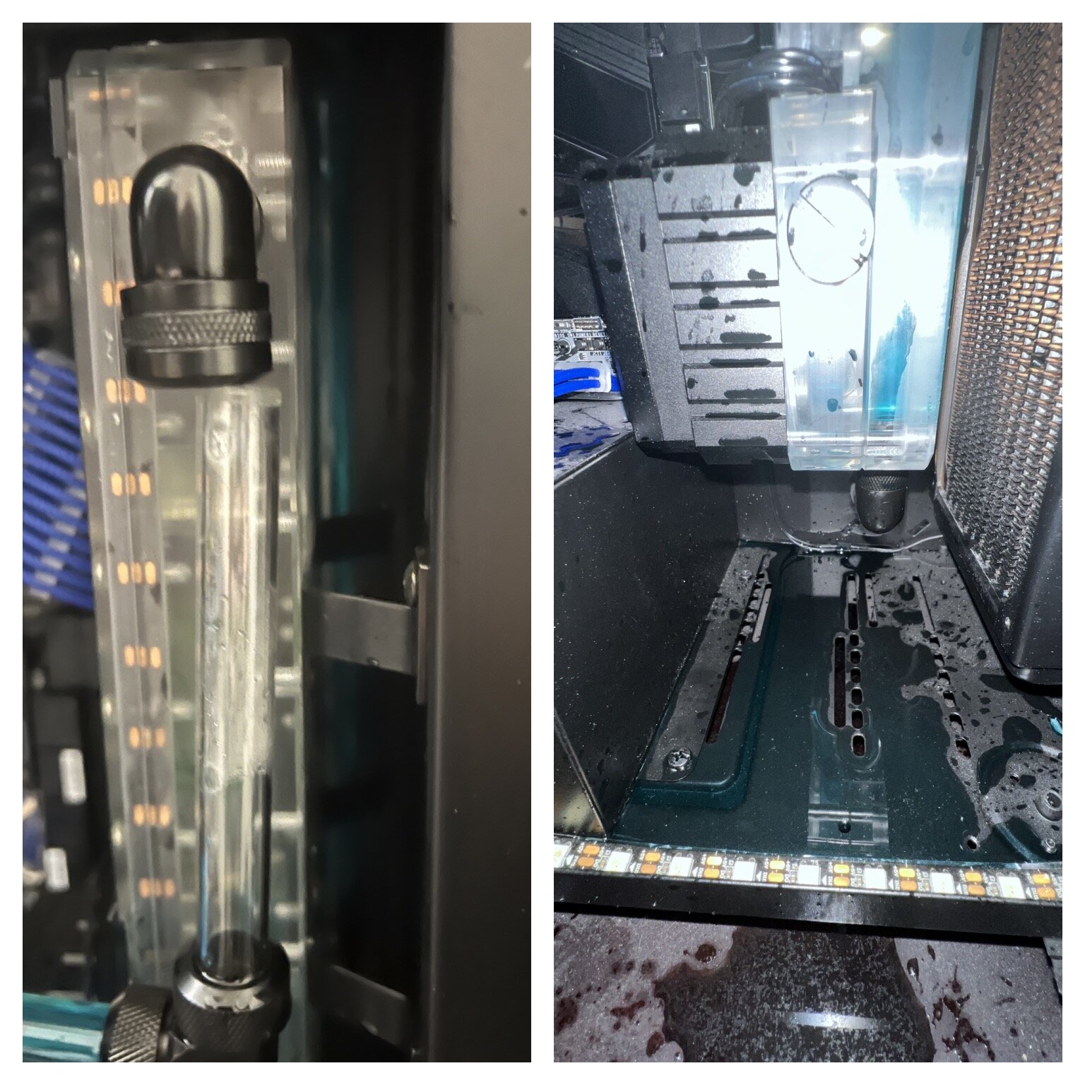

Well it appears the time has come to test the warranty I bought with the system. Didn’t think I would need it so soon and with so few hours on this system….but todays the day.
OG Gamer
  Quote hoserator Quote  Post ReplyReply bullet Posted: 20 Mar 2022 at 11:46pm
Oh no, no worries, DS will work with you to get it running again.
It looks like the tube was not seated tight enough and shipping might have loosened it enough to pop out with the coolant pressure. It is an easy fix if no hardware was damaged by the coolant. It should be non-conductive so.....
When you contact DS, find out what coolant was used and get some extra from them or a retailer since you cannot mix them.
Keep us posted. Good luck.

Yeah I agree. But hey it lets me address some other issues too. It appeared that some mold was in the reservoir and the acrylic on the cpu cooling block has hairline cracks around where the lines go in.

No leak over time, literally, the pipe just popped it’s fitting. Fitting seems to just allow the pipe to slip in and out, looks like the fitting is meant to be loosened or tightened, but it doesn’t screw/unscrew….but in hindsight, I don’t think it’s been leaking but noticed that for a closed system the fluid has evaporated a fair bit in the time frame I’ve had it.
That is one of the mysteries of open loops. I have to add a bit of coolant every once in a while and I know there are no leaks. So where does it go if its sealed tight?
Yeah always wondered that especially with those fully sealed systems. Just soooo bad to try to top this setup off with fluid. Access to the tank is ridiculous, has about an inch of clearance from caps to the radiator above and also has a pipe in the way lol.
permeation.
