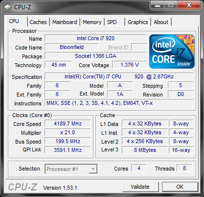

  Quote Dragoonseal Quote  Post ReplyReply bullet Posted: 12 Jul 2010 at 7:23pm
how can you have a CPU multi of 21? LOLLOLLOLLOLLOLLOLLOLLOLLOL
Wait, what am I missing here? I thought all 920s had a multi of 21? I know they're officially listed as 20, but as far as I know most any motherboard can set them to 21.
Have you been using 930s for too long Justin? Hahaha
