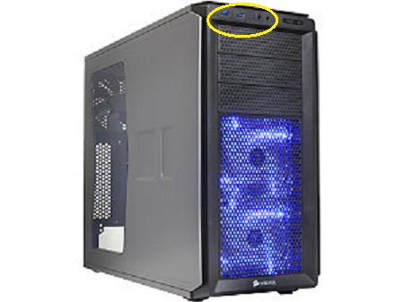

  Quote Snaike Quote  Post ReplyReply bullet Posted: 14 Jun 2014 at 9:03am
I don't know if this information is helpful or not... but on the Vanquish II case (Corsair 230T) there are audio plugs front, too. Audio out, mic, and 2 USB ports with the power and reset buttons.
