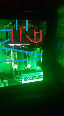

Here is my terrible picture, and crudely drawn idea of what's going on with airflow...
There's a USB expansion card right above the 3rd (or 1st) fan, hence the pitchfork... It only covers 1/4 of the fan, however.
Edited by Turbatus - 28 Feb 2016 at 5:45am

  Quote bprat22 Quote  Post ReplyReply bullet Posted: 28 Feb 2016 at 7:16am
Maxing the fans out might lessen longevity of the fan, but a few years should be good to go.  Tough to say with the fans.  Some fans run at max all the time and never need replacing.    I have case and an A70 air cooler's  fans that have been running at near max for years and never had to replace one.
I would set the fans on the card to their lowest setting while staying 79 C or less.   I wouldn't think 95% rpm is needed, but every setup is different.
Edit.. so there's no side fan next to the cards?   Any room to mount even a single 120mm fan?  Side fans, from my experience, make a huge difference for the graphics cards.
Love your pic.  Hahaha      Kidding, I do get the idea.    I'd put the top fans pointing out.

I think the reason that DS has the top fans set as input is to help pressurize the case. The Velox is a leaky case with all of the ventilation holes. Positive pressure will help keep the dust out of the case.
If it was me and the two side fan mountings are there, I would add the two side fans and change the top fans to exhaust. Then adjust your fan speeds.

Just thinking, with the inverted mobo, the Strix fans point up and are intakes.  The top fans in the Velox might be blowing in to feed fresh air right into the fans.  With no side fans, that might be a better setup.  Not sure.   Trying the fans both ways will tell if there's any benefit one way or the other.
Edited by bprat22 - 28 Feb 2016 at 9:31am

  Quote bprat22 Quote  Post ReplyReply bullet Posted: 28 Feb 2016 at 10:18am
Graphics card's fans are all intake.

  Quote Turbatus Quote  Post ReplyReply bullet Posted: 28 Feb 2016 at 12:07pm
Then I'm an idiot lmao... I assumed they were all exhaust to get heat out, not bring in cool air. That being the case, I can understand why the top two on the case are intake...

reference nvidia cards use a blower that pushes hot air out the rear of the card, but these custom cards use multi intake fans that push cool air through the heat sink in a downward direction and have a directed flow path kind of in a down and out the sides direction that wicks the heat away from the gpu and into the case where case fans are then expected to push the hot air out of the case.  water-cooled gpus move the heat through the liquid to the rads and the rad fans push or push/pull it out of the rig.

So with the heat sink being in the front, is it safe to assume that the hot air is exhausted to it, then blown downward and out through the DH-15 fans, and out of the case? Or could the case intakes be blowing the hot air the card wicks out right back on the gpu?

that's the thing with air cooling.  you have to make sure all fans work in synergy.  you'd like to avoid a situation where hot gpu air is blown all over your cpu and vice versa.  the main thing is to get all hot air out of the case asap.  you want a balanced fan config.  if you had all of your case fans config'd as intakes two things would happen: 1) the fans would work against one another; 2) too much positive pressure would suck in air through every crevice and bring dust along with it.  you'd have to pretty much line your entire case with dust-catching mesh.
if you put all exhaust fans in your case, you'd: 1) again have the fans working against one another; 2) create a negative case pressure situation.  fans don't create air they move it.  negative case pressure relative to the surrounding environment causes air to be pulled in, again, thru all of the cracks and you get the same dust control problem.  you want to lean towards positive case pressure, but overall you should be looking for a balanced config between intake and exhaust.  you can control dust better this way by putting dust catching mesh on intake fans typically front of case and bottom of case.  exhaust is typically rear of case and top of case.
