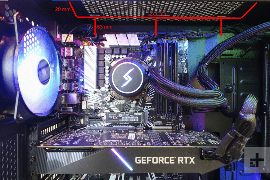

I promise nothing because I cannot verify. However, based on the photos in the following article:
Digital Storm Lynx review | Digital Trends
Looking at the mounting slots, including how they are shifted away from the motherboard side, the top panel should accommodate up to two 120mm fans and/or a 240mm radiator. I would recommend at the very least measuring.
L: 277 mm
W: 120 mm
D: ~53 mm (including fans)
To check RAM, motherboard, and cable clearance, measure from the outside edge of the inner slots of the top panel down 53 mm.
(A quick/rough measurement guide)

  Quote HockeyBuck Quote  Post ReplyReply bullet Posted: 18 Dec 2021 at 9:27pm
From the DS Lynx case specs:
Radiator Options
Front - Up to 240mm / Front - Up to 280mm / Front - Up to 360mm
So front rad is the only option.
