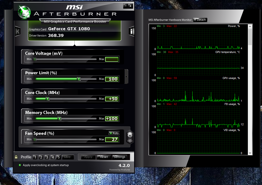

Hello! Haven't tested in game yet, but from the looks of things this computer is going to be awesome!
I noticed that the installed GTX 1080's overclock is very conservative: the power limit hasn't been touched, with the core at +50 and memory at +100. The GPU is watercooled, so I am confused as to why it wasn't pushed any farther. Is it the 600 watt PSU?

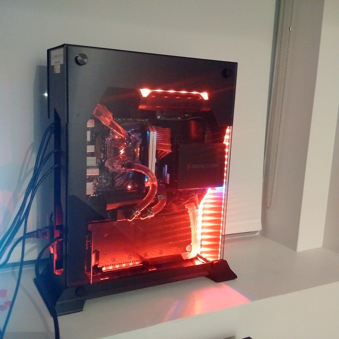

Here is a picture of the system up and running!
Bolt 3:
LC'edIntel i7 6700k @4.6gHz
LC'ed nVidia GTX 1080 @2038mHz
16GB 3000mHz DDR4 Corsair Dominator Platinum
250GB Samsung 850 Evo + 1TB WD Caviar Black

  Quote Salangsang Quote  Post ReplyReply bullet Posted: 30 Jun 2016 at 8:42pm
Under load temps were sitting at ~46-48 celsius when I pushed clocks down to stock in Heaven. After dialing in +200 to core and +500 to memory, temps stayed ~50. WHen I was actually in game (Battlefront), GPU stayed stable at 55C with the CPU hitting high 60s and low 70's.

  Quote DST4ME Quote  Post ReplyReply bullet Posted: 30 Jun 2016 at 9:05pm
Your control center software from DS should be able to let you change led and etc.
OK if after playing games for 30 min the max temp was 70c then you got room to push the oc, Here is a guide if you like
