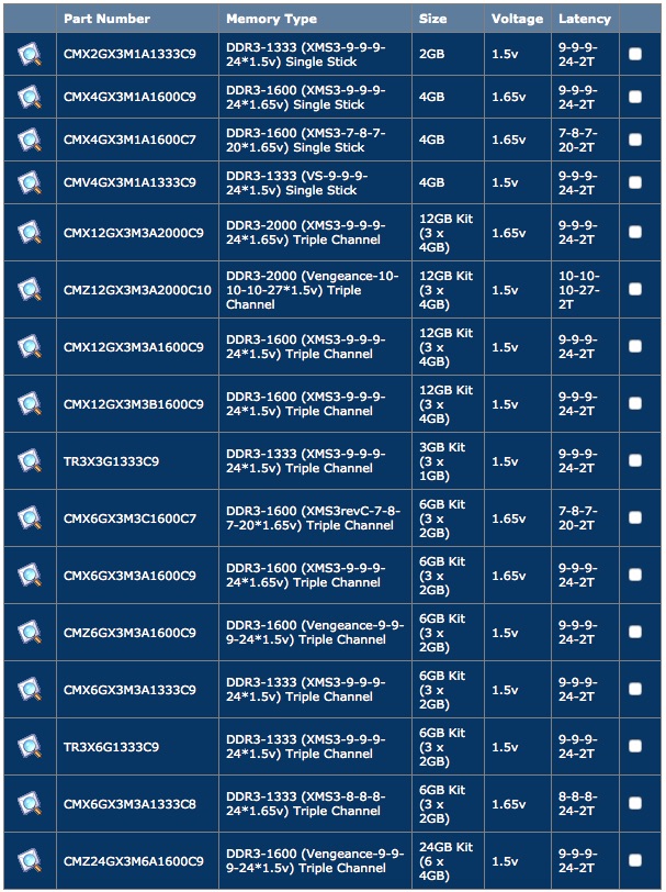

Are you sure about the 8GB modules working in my motherboard? The manual clearly mentions a limit of 4GB per slot. Plus, the online Corsair Memory Configurator only recommends 2GB and 4GB modules.
I attached a screenshot that shows the recommendations.
By the way, I don't know much about latency or what the numbers mean. I'm tempted to match the specs of my current memory modules (1600MHz, 9-9-9-24) just because I know it works. However, I'm open to other suggestions if you think I can do better.

  Quote bprat22 Quote  Post ReplyReply bullet Posted: 04 Nov 2014 at 12:30pm
The 9-9-9-24 is pretty common.   Go for it.    That mobo doesn't officially support the 8gb ram sticks, from my understanding, but others have done it. No guarantees, though.
If you don't need more than 12gb ram, like for gaming it's plenty, then 3x4gb sticks is best.   A lot less chance for even overclock problem with cpu if you have it.

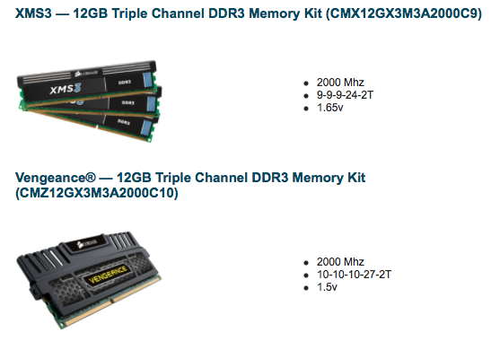

Which of these two choices would be best?
  Quote bprat22 Quote  Post ReplyReply bullet Posted: 04 Nov 2014 at 2:04pm
I'd go with the lowest latency, the 9-9-9-24, not that it makes a huge difference.
Not sure the site your on, but the 1600C9 version for less money would be my pick. It all comes in stock at 1333, the other speed the tested speed, and you might not get to 2000. 1600 is more doable.
But, it all works.

  Quote Meller Quote  Post ReplyReply bullet Posted: 04 Nov 2014 at 5:51pm
I'd personally go with the lower voltage memory. XMS is good and low-mid level grade.
Vengeance is decent mid level memory. It's, what I'd take.
2000 mhz is kind of weird speed of memory too.
I'd definitely look at some 1600 or 1866 memory.
