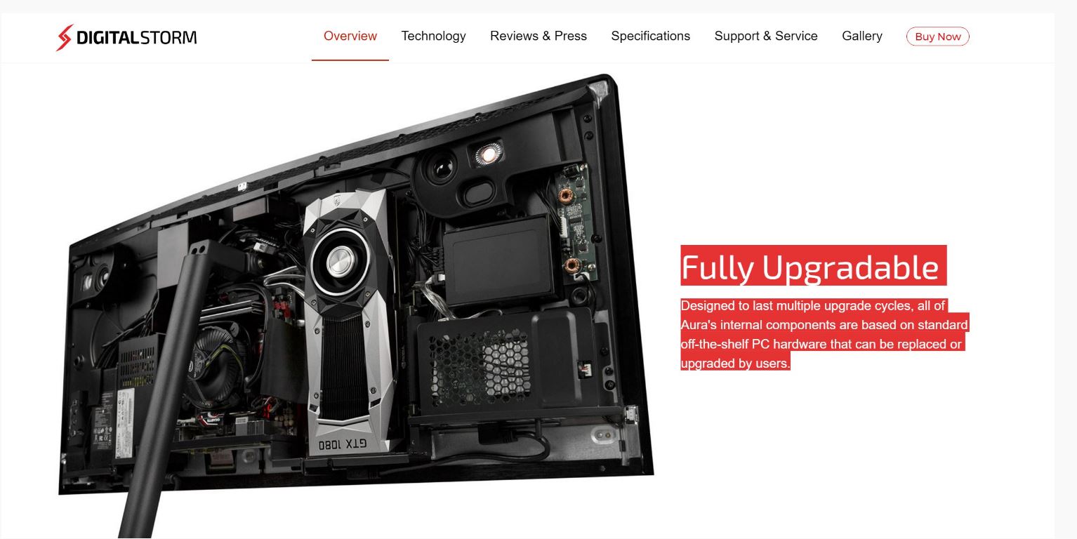

ok, thank you but i was led to believe the Aura AIO model is fully upgradeable to some extent.
  Quote bprat22 Quote  Post ReplyReply bullet Posted: 19 Mar 2017 at 12:36pm
It is fully upgradeable.   Every part in there can be swapped.   But, and the psu is a good example, you have a lot more restrictions on what fits then you do with a full size case. Plus, you can't swap the screen without sending it in which means shipping both ways and the cost of the screen , beyond warranty.

Sorry for the late reply, the Aura cannot power a GTX 1080 Ti or TITAN X due to the power draw. However, to be honest, the display can deliver a top tier experience with a GTX 1080, it does not need a GTX 1080 Ti either.
acuraice View Drop Down
Joined: 25 Dec 2016
Posts: 24
  Quote acuraice Quote  Post ReplyReply bullet Posted: 20 Mar 2017 at 2:32pm
well that's disappointing :( So if i were to buy it, i could never upgrade the gpu past the 1080 founders edition??? U just saved me over $3k
How can they claim its fully upgradeable but u cant upgrade any gpu past the 1080?????

still i was under the impression the Aura was designed to last for multiple upgrade cycles as the ad clearly states, but come to find out it's already maxed out??? ill wait until they refresh the model with a higher resolution screen, a minimum single 1080 ti and a swappable psu supply.
Edited by acuraice - 20 Mar 2017 at 3:05pm

It uses a FlexATX PSU. Right now there isn't a good option, but there is a roots effort to get a 500W FlexATX unit made, which could support a Titan X or 1080 Ti.
But if you want full flexibility, you may want to look at just getting a small form factor computer and connecting it up to a monitor of your choice.

  Quote acuraice Quote  Post ReplyReply bullet Posted: 27 Apr 2017 at 3:39pm
i just can't believe that it's sold as fully upgradable but you can never upgrade the gpu to anything higher than a 1080 founders edition. Everyday i go to the website just to admire it but keep telling myself no, don't buy it or you'll be in the same predicament you're in now with this pos imac i have. I wouldn't mind buying a tower and a separate monitor but it gets very confusing when trying to configure the tower versions vs the aura. also i have no idea what stuff to buy to make it work with a very large high def tv screen. I basically want to buy a new pc gaming rig that can handle anything i throw at it for many years and when it gets slow and sluggish, be able to upgrade the cpu and gpu and be ready to go for another few years. But it seems hopeless. i get nothing but runaround answers to my questions or disappointments as in "you just can't do that" or "no it's just not powerful enough". Im a hair away from saying the hell with pc gaming, buying myself a ps4 and a huge tv to play on. i just wish i could play with a mouse and keyboard on a console., not sure if they make such a device. I love having my computer and gaming all in one machine. Being able to minimize a game , look up a youtube video for a game walkthrough and then boom switch right back to the game. Not possible on a sh*tty console, at least not with such speed and ease. I just wish they would refresh the aura model , throw more power into it, give it a better screen, and a 1080ti option, and i would have already ordered it. I guess i'll just have to keep waiting, while everybody else gets to p;lay all the cool games.
  Quote bprat22 Quote  Post ReplyReply bullet Posted: 27 Apr 2017 at 4:06pm
I don't understand the problem, with all due respect.   The gtx 1080 is all the Aura display needs for excellent gaming.   It's not a 4K display.   As far as future upgrading, a new generation video card in a year or two will, if history is any indicator, will be more powerful than the 1080ti and need less power to run.    You also can't install any motherboard you want, but the Aura has what it needs.   An all in one computer will always have limitations due to its size.
You're better off, if you want total upgrade ability, is to get a seperate tower like you mentioned, like an Apollo or Bolt 3. The size of the TV doesn't matter, just the resolution like 1920x1080 of hi def. We can show you a build that'll play great for under $2500.   Get the computer and get whatever monitor you want.
The system is upgradeable, but(there is always a but)it also still has limitations, especially being an AIO. In the future, as BPratt said, you can more than likely upgrade to a better card(if needed) or even upgrade other components within the tolerance of an AIO. What you are suggesting is by saying it isn't upgradable is like saying a Small Form Factor case (the Bolt) isn't upgradeable because it won't fit an ATX mother board. New video cards are coming out all the time, hell my 2x 980 TIs feel like dinosaurs now and I only got them last spring lol. That is why most of us have normal towers because it allows for more options. Sick of gaming at 1080p? Get a 1440p or 4k monitor not a whole new system.
While configuring a desktop may seem daunting it is actually pretty easy and everyone here is very helpful at helping you get something that fits your needs and stays with in budget.
Simple solution: DO NOT BUY AN AIO SYSTEM!
The "Fully Upgradeable" means that if you go with a lower tier GPU, CPU, and less RAM, you will be able to upgrade those components later on down the road to one of the better/best component options shown for your AIO configuration. It doesn't mean you can put "anything" in it. I do not know if you would be able to change the motherboard from a MSI Z270I to an ASRock X99E.
I should point out that such an "upgrade" doesn't make much sense given the room, PSU, GPU, and RAM constraints with this AIO and one of the few advantages of going with the X99 in this case is simply being able to use a CPU with a higher number of cores, which most games will not utilize.
If future-proofing is on the top of your priority list, then go with a tower desktop and forget about AIOs. In my opinion, their AIO is just an oversized, powerful, wide-screen pseudo laptop that doesn't fold up. Given the options that are available for it, a fully upgraded Z270I Aura should give you, at the least, 4 years out of it and that's a very conservative estimate depending on how your needs grow. I don't see the gaming industry catering to 6-10 core CPUs anytime soon since 4 is the current standard and most gamers would rather put their money into the GPU. The 1080 8Gb Founders Ed. is still very new on the market, so... The system is more than sufficient for gaming, and when it comes to multi-tasking(such as gaming & you-tubing) upgrading the RAM from 8 to 16Gb would help more while a 1080Ti is just throwing money away.
If a 1080Ti is a must-have and you intend to eventually game at 4k, again, your only option is to ditch the AIO and select a tower desktop that will give you more flexibility for upgrades. However, keep in mind that you may end up paying a lot more up front if you still want a 34" 1440p res screen since that will have to be purchased in addition to the tower.

Well said everyone, if a GTX 1080 Ti is a must, then it's best to go with something like an SFF such as our BOLT 3 which can do that and you can use a separate display.
