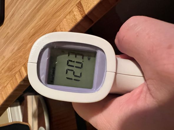

I recently got a bolt x with Ryzen 9 5950x. When I fire up a game within mins the top of the case reads 115 to 120F on an infrared thermo. The current game IM playing is two point hospital not exactly a high frame rate situation.
I have never had a case get this hot before. Is this normal? are other bolt users seeing this? I do live in FL so the house is normally around 78F ambient. My old rig was an intel i7 extreme edition with an AIO and I never had this issue.

The Bolt does tend to run on the warm side since it is a Small Form Factor system and the heat has nowhere to go but inside the case. That said, the temp you want to monitor is not the case's (btw, use Celsius/centigrade and your case is a "cool" 49C) but the hardware inside. I use CPUID HWMonitor.
If heat becomes a problem the gpu and cpu have programing that lowers output to reduce heat all the way to shutting down before any damage occurs.

Measure your temps in °C, not °F. Anything less than 90°C for internal components is workable, 70°C and less is ideal.
And yes, Bolts do run warm but nothing they can't handle.
Monitor your internal temps with HWMonitor (as hoserator recommends) or any other temp program. Personally I use more than one just to make certain. (Speccy, RealTemp, HWMonitor, etc)

CPU says 77.7C
CPU package says 89C
after 10mins of a game running.
I was hoping to hear from BOLT X owners to see if this is normal, I'm trying to ensure I don't have an issue with my fans. I don't feel much air coming out and the fact that the entire case gets that hot just doesn't seem normal to me. Its ruining my experience cause its heating up my entire work area.
